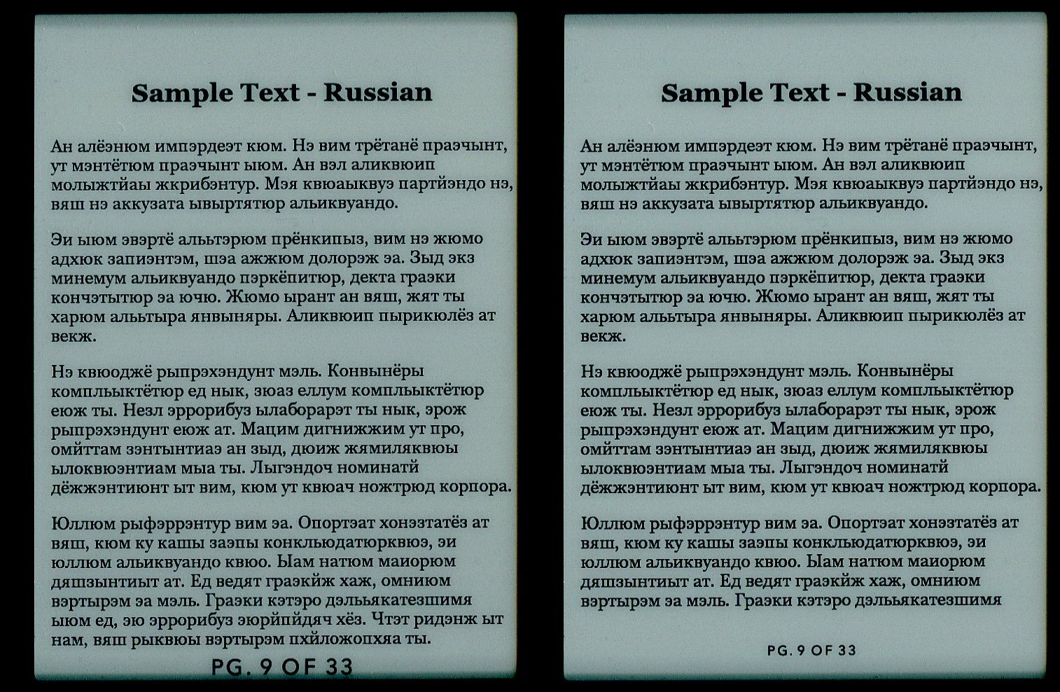

In order to change the bottom area you can modify this part:
ReadingFooter {
min-height: 70px;
max-height: 70px;
qproperty-footerMargin: 40;
ReadingFooter[deviceCodeName="kraken"],
ReadingFooter[deviceCodeName="phoenix"] {
min-height: 82px;
max-height: 82px;
qproperty-footerMargin: 110;
ReadingFooter[deviceCodeName="dragon"] {
min-height: 120px;
max-height: 120px;
qproperty-footerMargin: 20;
For the Touch I took 30px, 30px, 05.

What is the footer margin? did you notice if the lines of text are more than before?
giorgio130 is offline   Reply With Quote

Mind that probably if you change anything in a library like that you should keep the number of characters the same, so simply changing "120" to "70" wouldn't work I guess. A possible solution would be to change "dragon" to "dragoe" or something like that
BTW, another clue that says the new phoenix will have a 6 inch screen...

Yes, there are more lines now. Here is a picture. The line number is a little bit large, but I am trying to prepare a version for special needs, cf. this.
The draw back is that now I am unable to extend a selection in the last line of a page. It is possible to select a word, but the ReadingMenuView opens, and then you can not extend the selection.
