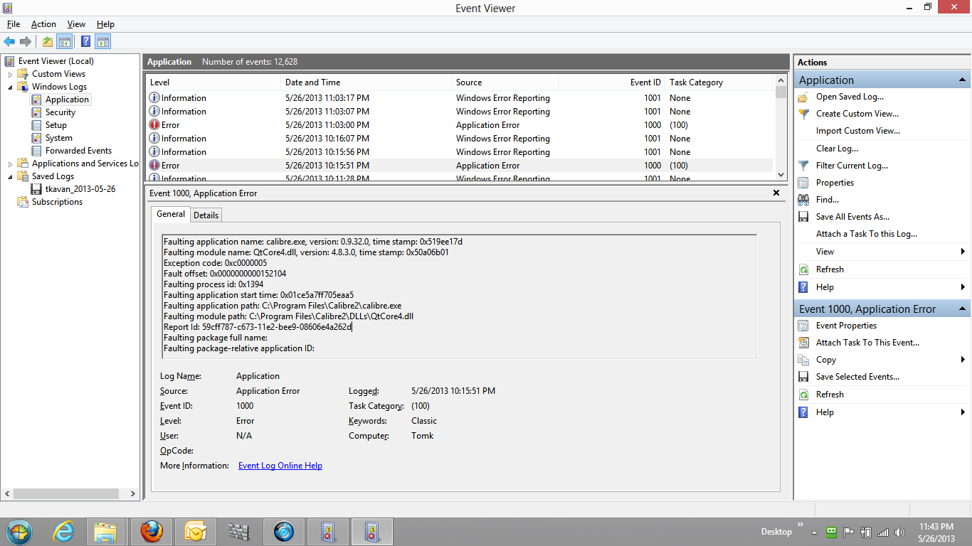

Further to my message a few minutes ago:
I looked around in the event log and found a reference to Calibre. It doesn't mean anything to me, but may to you. A screenshot is attached.
