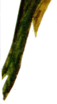

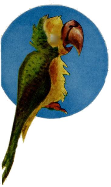

From time to time, I bump on these kinds of things. I'd like to find a practical solution for this one:
As you can see, It's a bird (head + tail) placed in the green area and standing on the left side of a page. My dream would be to know how to wrap the text around (intended light blue display).
I even cut the bird in two pieces and tried to stick the pieces together but I failed miserably (it worked for one font-size, but increase it and the tail goes away... )
Would somebody accept to publish here the relevant code?
ID:	106078   Click image for larger version
ID:	106079   Click image for larger version

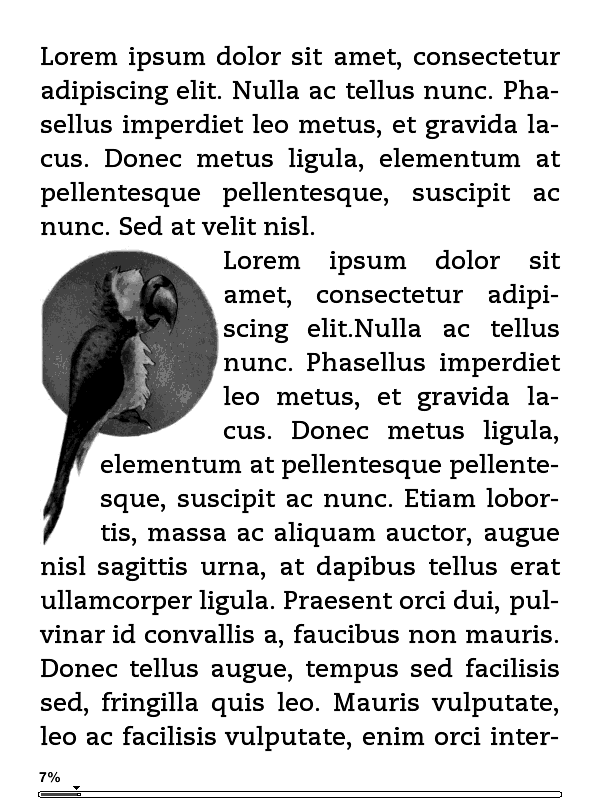

Something like this:?
https://www.mobileread.com/forums/att...1&d=1369173498
I made it with the following classes:
p {
  text-align: justify;
  margin: 0;
.parrot {
  background: url(../Images/bird.jpg) no-repeat top left;
  background-size: 183px 307px; /* the half of 366px and 614px*/
.box1 {
  float: left;
  top: 0;
  left: 0;
  width: 183px; /* the half of the original width: 366px;*/
  height: 195px; /* the half of the original height: 390px; (for the square section of the img */
.box2 {
  clear: left;
  float: left;
  top: 0;
  left: 0;
  width: 60px; /*120px;*/
  height: 100px; /*200px;*/
In the .xhtml file the text goes in the following way:
<p>...something...</p>
<div class="parrot">
<p class="box1"></p>
<p class="box2"></p>
</div>
Maybe that code can help you.
Regards
Rubén

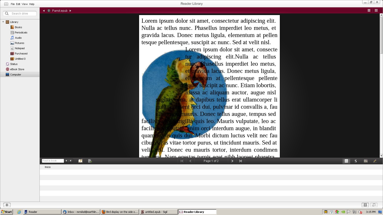

This is what happens in the Sony Reader Library.
It bleeds over.
It bleeds over.
Maybe it's a problem of the Sony Reader and in the Sony device works fine. Let's wait for the answer of roger64 to know if it works for him.
Old 05-21-2013, 08:42 PM   #12
Posts: 85,852
Karma: 154365287
It does not work in ADE 1.7.2 or ADE 2.0.
Old 05-21-2013, 08:54 PM   #13
RbnJrg
Posts: 1,938
Karma: 9699999
Join Date: Mar 2013
Device: Kindle 4 NT
It bleeds over.
Well, the problem in the Sony Reader is that the reader doesn't resize the image. The original image was 366px x 614px and in the css code I used the half of that size. But Sony Reader still uses the original size so it ignores the property background-size. I resized the image manually before using it in the .epub and I got the following results in Sony Reader:

@RbnJrg
Hi Jorge
Thanks so much for your help. I have really spent hours trying to do it and had given up. Your EPUB looks good. I will study it closely and look how it displays on Kobo and later how it goes to PDF with Prince.
ADE is OK. Prince too. The only thing, Kobo does not agree (text mixes with image), but Kobo is backward on so many fields with formatting, I find it hardly surprising.
The code cannot be more compact and clearer. Use of background, background-size (I noted for this one to be careful) and boxes is really very convenient.
