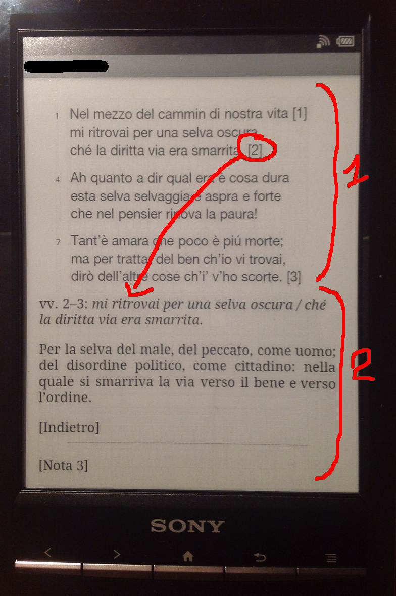

Interestingly, I wrote about parallel texts here: http://www.albertopettarin.it/rs.html
In short: I think that this kind of functions should be put in the reading systems, not in fancy CSS/JS gimmicks. The eBook should contain only those metadata that make the app "recognize" that parallel display (or other "advanced" rendition) is needed.
(A picture is worth 1,000 words, right?)

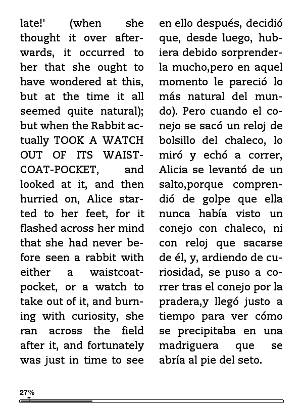

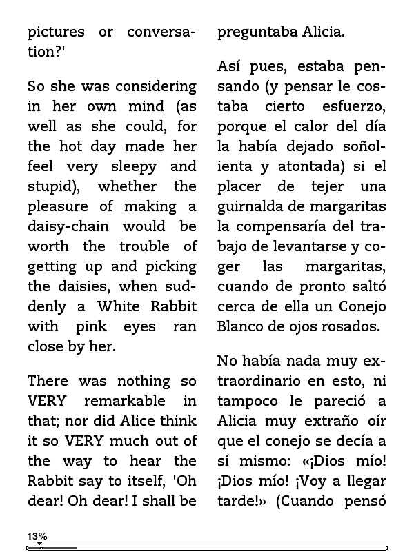

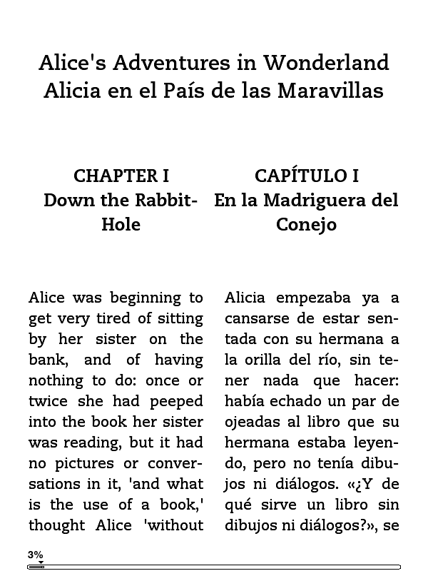

What about a two columns layout? It works fine in some eReaders (i.e. Kindle) although not in ADE
h1 {
  clear: both;
  font-size: 1.4em;
  margin: 0;
  padding: 1em 0 2em;
  text-align: center;
h2 {
  font-size: 1.2em;
  margin: 0;
  padding: 1em 0 2em;
  text-align: center;
p {
  font-size: 1em;
  text-align: justify;
  margin-bottom: 1em;
.col1 {
float: left;
width: 50%;
.col2 {
float: left;
width: 50%;
div.col1 p {
  margin-left:0;
  margin-right: 0.75em;
div.col2 p {
  margin-left: 0.75em;
  margin-right: 0;
In the .xhtml file the code would be:
  <h1>Title</h1>
  <div class="col1">
    <h2>Title in one language</h2>
    <p>...Text in one language...</p>
  </div>
  <div class="col2">
    <h2>Title in another language</h2>
    <p>...Text in another language...</p>
  </div>
As you can see, no javascript
