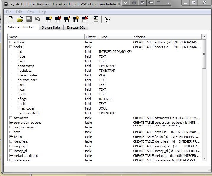

Why couldn't your plugin use the id's it gets from Recoll (i.e. #cid:=34 or =56 or =76) to access the metadata.db directly. My understanding is that the id (which Calibre puts at the end of the book directory names) is the primary key of the book table - see attachment.
Good luck - BR
