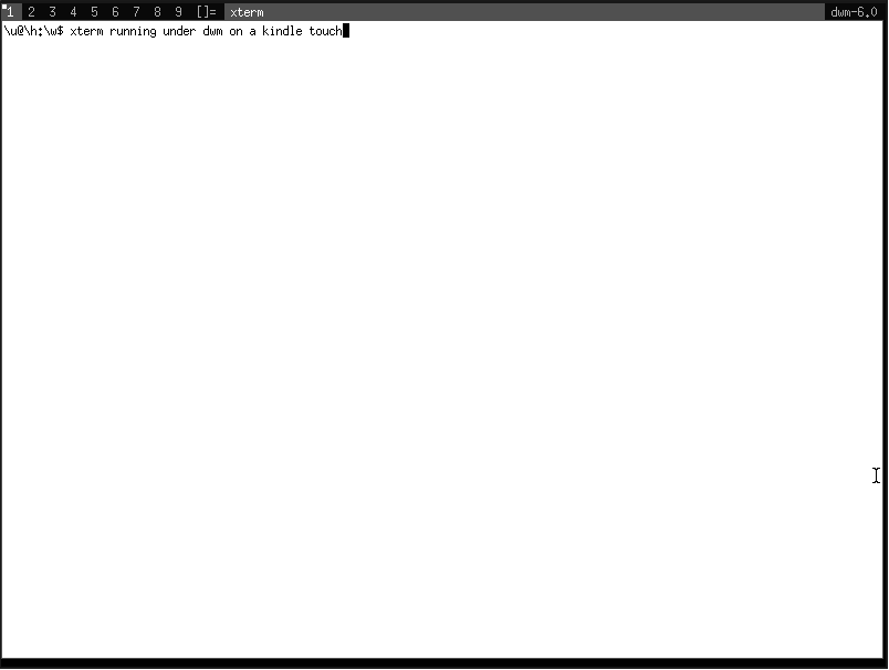

like this:

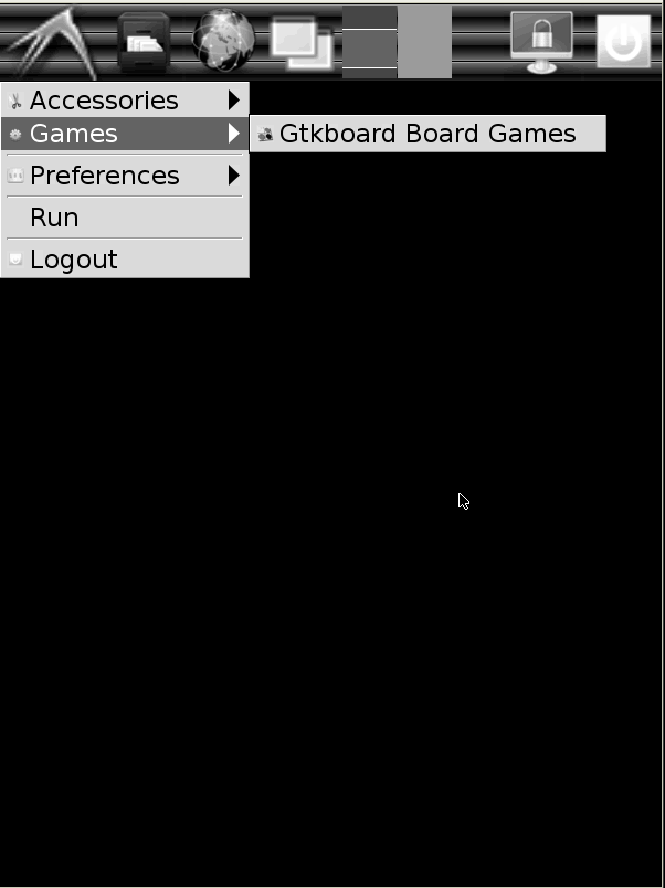

I chose lxde
it was necessary to run
while :; do eips "" ; usleep 30000 ; done;
still figuring out why...
