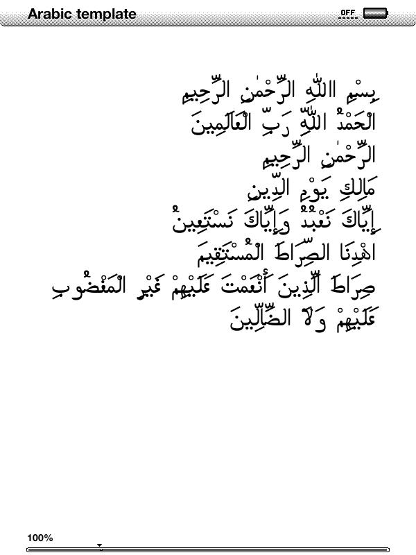

I did some experiments and found out that eInk Kindles actually support Arabic vowel signs, if you keep the styles simple.
(Unfortunately, you cannot embed Arabic fonts.)
@chaditrad: To automatically generate a master .mobi file, download Kindle Previewer and open your .epub or .html files with it. Kindle Previewer will automatically generate a .mobi file.

... I did some experiments and found out that eInk Kindles actually support Arabic vowel signs, if you keep the styles simple.
(Unfortunately, you cannot embed Arabic fonts.)...
I'm a bit confused. Didn't you embed the fonts in post#5 attachment?.
Old 03-29-2013, 03:25 AM   #12
Doitsu
Doitsu's Avatar
Posts: 5,941
Karma: 24259515
Device: Kindle PW2
I did. But for some odd reason, Kindles don't use the Arabic glyphs, when you embed Arabic fonts. (If you mix Latin and Arabic text, the Latin glyphs actually show up.)
That's why I didn't embed fonts in my latest test file.
Also since I figured out that Arabic vowel signs are supported up to a certain font size I created a new test file without embedded fonts.
