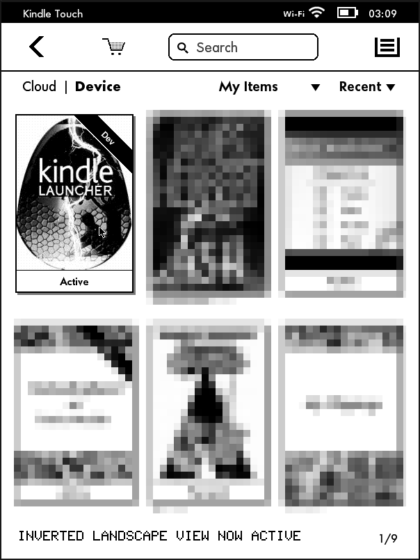

Here is a simple extension for the TOUCH and PAPERWHITE
(Thanks to Jimmy-Jim for confirming PW support)
Installation:
Just splatter the extracted rotations folder into /mnt/us/extensions like usual.
Effect:
It sets the rotation to "inverted landscape".
The next book you open will be in this view.
it DOES NOT AFFECT the main User interface.
Changing back:
To go back to ordinary "Landscape" or "Portrait" views just use the menu options in the reader itself... The moment you choose an alternate view then the "inverted landscape" view is gone, for good.
Do it again?
To re-activate "inverted landscape" again it is required to click the button in KUAL.
SUPPORT:
K2, K3, K4 are NOT SUPPORTED (you don't need it)
Name:	TightVNC: kindle:0.0_193.png
ID:	101691   Click image for larger version
Name:	TightVNC: kindle:0.0_194.png
File Type: gz rotations-extension-enabler-for-Touch-and-Later.tar.gz (800 Bytes, 541 views)
File Type: zip rotations-extension-enabler-for-Touch-and-Later.zip (1.3 KB, 756 views)

Don't use it on a Kinde 2, Kindle 3, DX, Kindle 4.
it will "show up" but is not required... as all rotations are already supported.
Thanks
