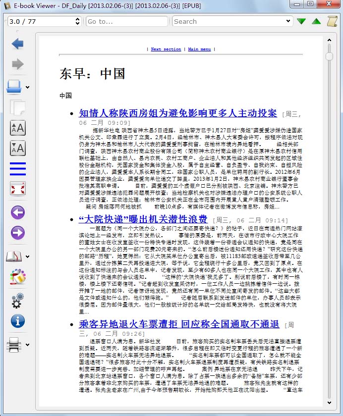

I'm trying to fetch a full-article blog RSS.
In my recipe, the value use_embedded_content was set to True.
Since each item of the blog feeds is a very long article, the page of table of contents in the resulting ePub turn out be very long!
I wonder whether I can shorten the stuff shown in the TOC page, or simply retain only the title of each feed in the TOC page.

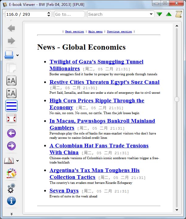

Hi, Kovid, Thanks a lot for your response!
Pls let me give you a example.
The first pic, the problematic one, shows a redundant TOC page of an ePub fetched from full-article RSS feed with built-in functionality.
My question is, whether it's possible to control/remove the introductory contents under each article title from the TOC page.
The second pic shows a very concise TOC page of an ePub fetched from full-article RSS feed with customized parse_index() recipe.
Thanks!

Sure you can control pretty much everything in a recipe by simply overriding the base class functionality. In your case you will want to override the parse_feesdd function to remove the description from the feeds.
I spent 2+ hours studying parse_feeds.
But it seems to be much more difficult than understand parse_index.
Could you kindly provide some clues on how to remove the description?
Thanks!

Call the base class parse_feeds, iterate over the returned value setting the description to an empty string for each entry.
Done with following codes
def parse_feeds(self):
feeds = BasicNewsRecipe.parse_feeds(self)
for currFeed in feeds:
for a,currArticle in enumerate(currFeed.articles):
currArticle.summary = ''
return feeds
Thank you!
return feeds
Thank you!
Sorry. It doesnot work.
currArticle.summary = '' would delete all the article content.
currArticle.text_summary is OK for the job.
Thanks!
Hi, Kovid,
Could you advise how to change the time format showing in the left picture above?
I cann't figure out how to handle the following properties of the Article object
formatted_date
date
Thanks!

Already done with following code
from calibre import strftime
                 currArticle.text_summary =  ''
                 currArticle.formatted_date =  strftime('[%Y.%m.%d]',currArticle.date)
        return feeds
Thanks!
