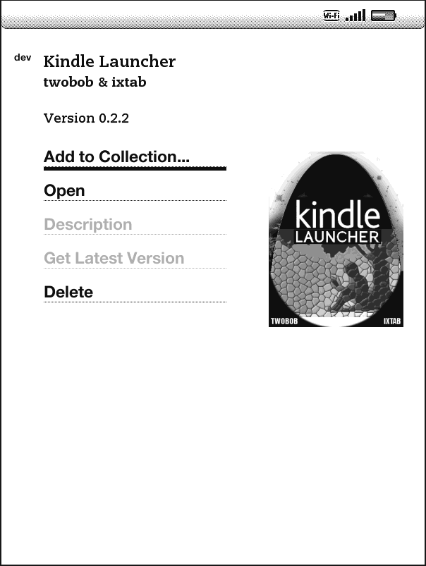

Worked Example of refactoring a launchpad script to KUAL
Where are we?
[root@kindle launchpad]# pwd
/mnt/us/launchpad
Let's look at what we want to port to KUAL

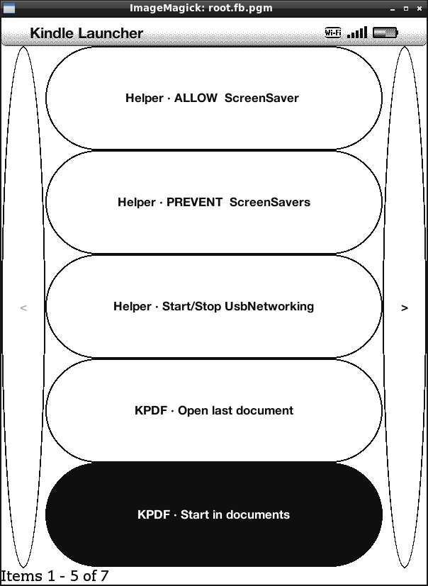

Convert Launchpad commands to other Launcher commands in menu.json
"items": [
"name": "KPDF",
"priority": 0,
"items": [
{"name": "Start in documents", "priority": 1, "action": "bin/kpdf.sh", "params": "/mnt/us/documents"},
{"name": "Open last document", "priority": 2, "action": "bin/kpdf.sh"}
[TABS FLATTENED FOR EASE OF READING]
(I did two for now.)
update config.xml
<?xml version="1.0" encoding="UTF-8"?>
<extension>
	<information>
		<name>KPDF</name>
		<version>0.0</version>
		<author>Hawhill</author>
		<id>helper</id>
	</information>
	<menus>
		<menu type="json" dynamic="true">menu.json</menu>
	</menus>
</extension>

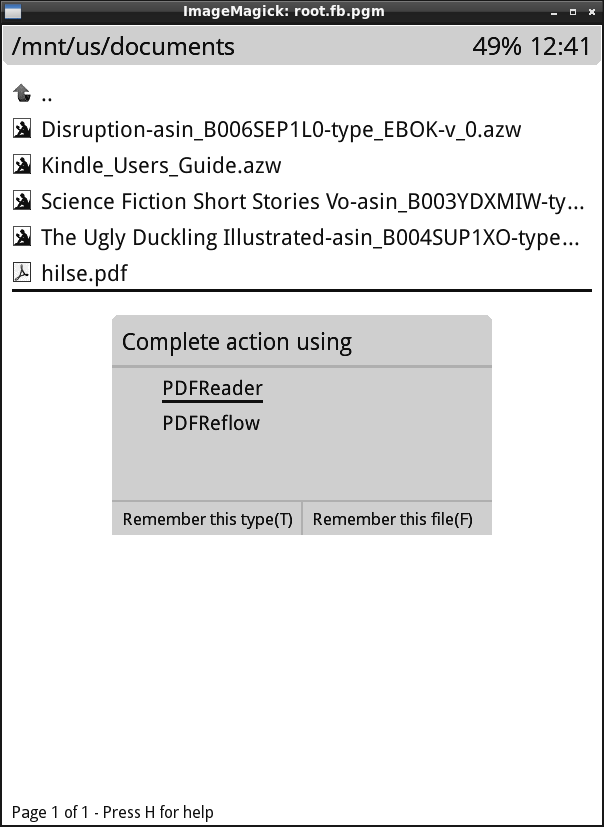

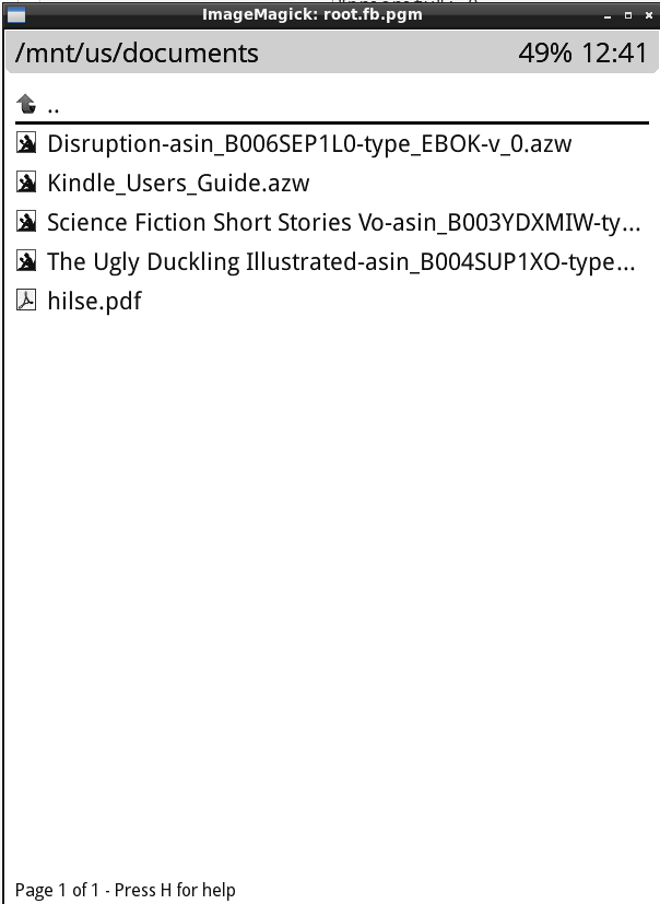

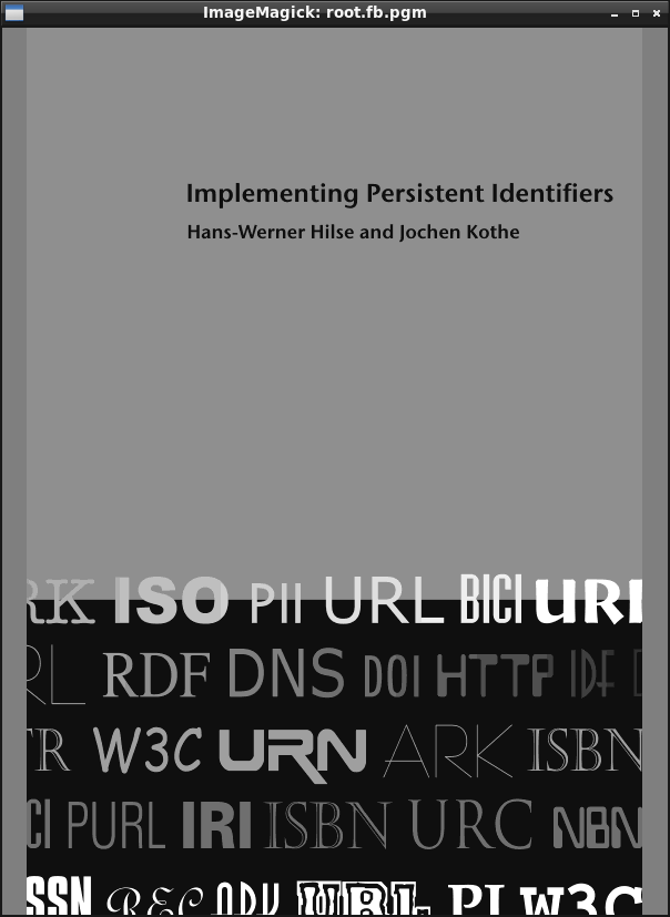

To Be Continued... seems to work fine.
Just extract the kpdf.zip in /mnt/us/extensions/

Great! Heh, I've seen that document's cover before ;-) (has been a nice experience to write, and I gained some citations within the scientific community...)
