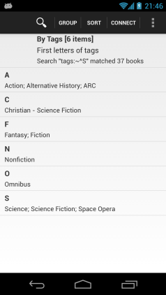

OK, I have a prototype implementation, and I want to sanity check it before I go on. I will do this with a set of screen captures.
The first shows grouping by tags/first letter.

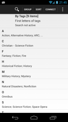

The second shows the result of a long press on "S". This is the dialog that you see, giving you the choice of finding all books that match the item or all books that do not match the item.
I tapped the "Matching" button, which says find books with a tag beginning with "S". The books have other tags, so those tags are shown as well. The header shows the calibre- and CC-equivalent search.
If I wanted to I could change the grouping to by Series, by Author, or by anything. I could even turn off grouping. I would see only the books that have a tag beginning with S. This behavior is like calibre's restriction, in case you have ever used that. @Dopedangel: this is how you would view authors of books tagged with "Fantasy". You would long tap on Fantasy, select "Matching" to get the books with that tag, then group by Authors.

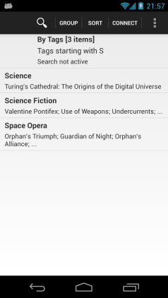

For the next screen, I cleared the search and then tapped on the tag "S" to open the list of tags beginning with S. I see three tags, one of which is not related to science fiction.
