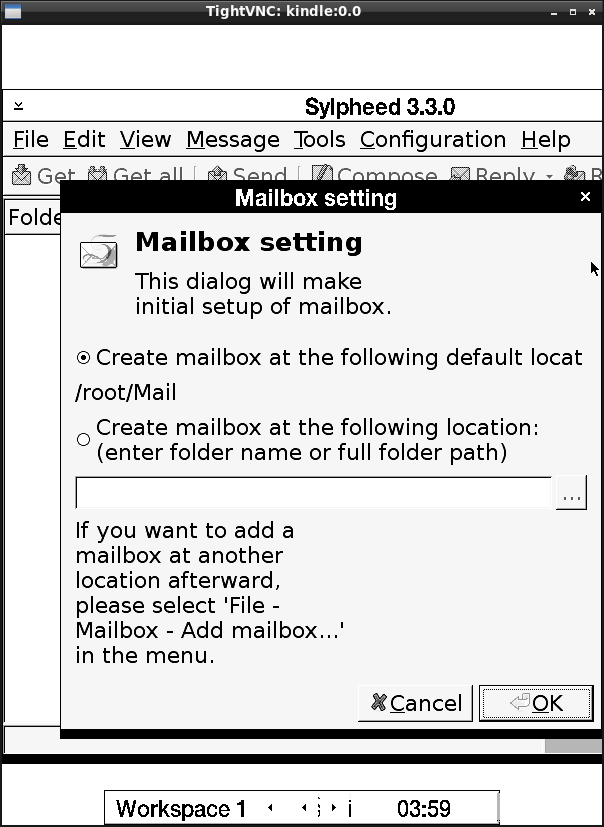

debian has it.. I could try to rip in later...
ID:	98824   Click image for larger version
Name:	TightVNC: kindle:0.0_077.png

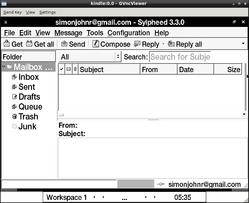

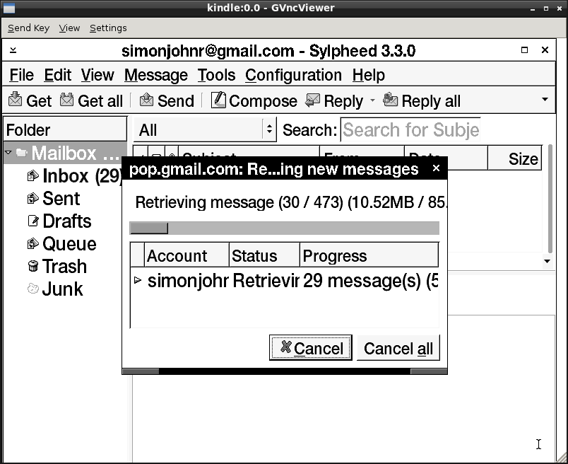

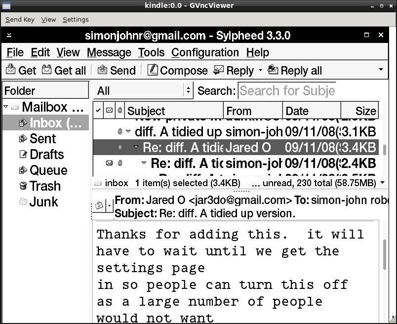

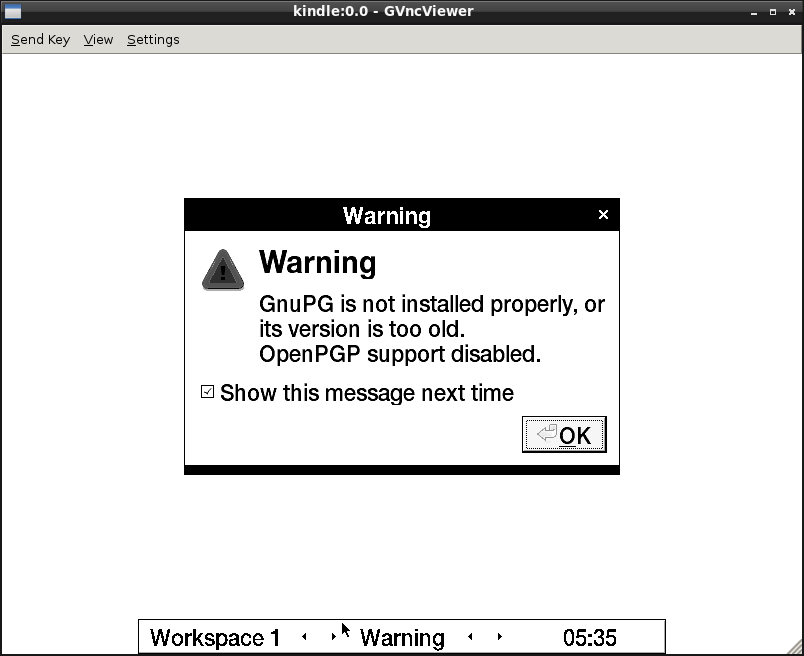

[root@kindle bin]# HOME=/mnt/us/export/sylpheed/ DISPLAY=:1 LD_LIBRARY_PATH=../lib:/usr:lib:lib ./sylpheed
Obviously you will need a working Xephyr.
I would advise you change your root accounts home dir to something on the FAT... or there will be configuration pain...
A window manager is helpful... I used blackbox
I used x11vnc here to type....
IT worked outside of debian however which was I could really hope for without a title hack. (attached)

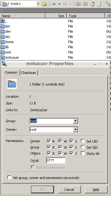

hmm.. mntroot rw
cd /
ln -s /usr mntususr
mntroot ro

alas, didn't do the trick. Same error as before.
