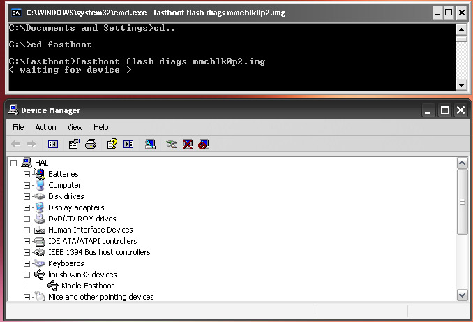

I have a K4 bricked with a frozen screen.
This picture shows about how far I have gotten.
I have successfully loaded Kindle Fastboot with MfgTool and I have HID complaint device int Device Manager.
Looking at the guide here http://www.mediafire.com/view/?xrn3v3ln6cn2n75
It looks like I should next update the device driver to Kindle-Fastboot.inf but when I try to do that windows xp says that it does not contain information about my hardware.
I don't know where to go from here.

32-bit or 64-bit xp?

32 bit
I also see that the guy that made the guide was repairing a kindle fire.
So I guess that explains it.
I guess I'll have to find a Kindle-Fastboot.inf driver for the K4

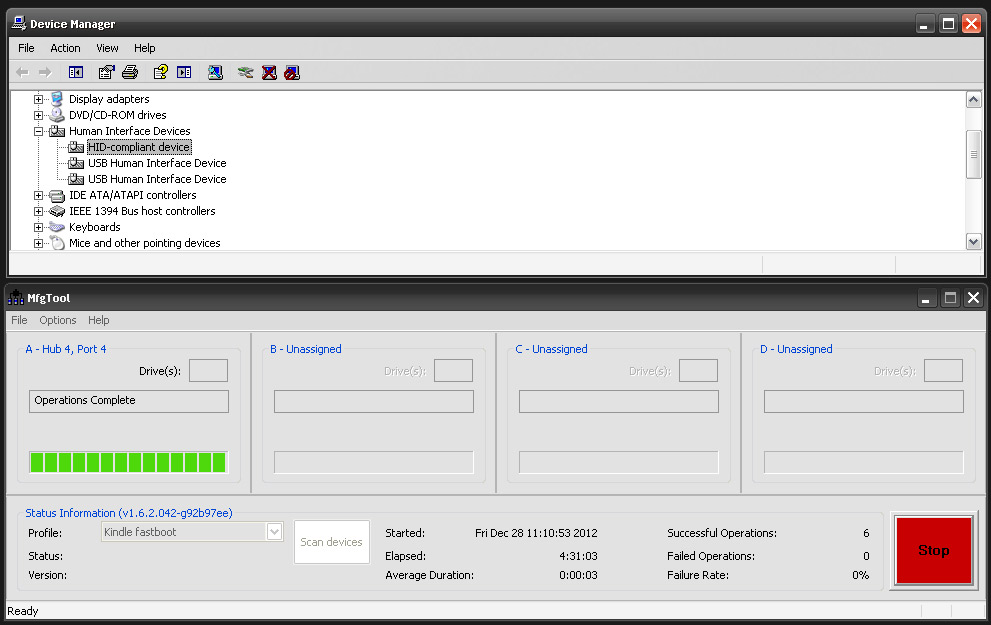

I made a little more progress but when i try to "fastboot flash diags mmcblk0p2.img" I just get < waiting for device >
Hmm... judging from what your screenshot shows, it should indeed work.
Sorry for not being able to provide anything more helpful, but you might consider using Linux instead. Any current "Live CD" (32 bits, to be on the safe side) should do - no need to install it. You can simply run it from a CD or a USB stick. Linux is much less picky about all these driver issues than Windows is. Downloading and executing fastboot should be pretty much all that is required.

Is that an elevated cmd?

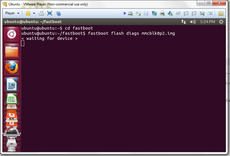

I installed ubuntu in vmware on my windows 7 machine and I still get < waiting for device > error when i try to fastboot flash diags mmcblk0p2.img
I don't know anything about linux
How do i make sure that the kindle is connected properly in ubuntu?

I also just tried it using XP in vmware on my windows 7 machine and I still get < waiting for device > error

Did you pass the USB port through to the VM? Remember that the kindle fastboot mode will terminate if the USB port gets disconnected or reset. In VirtualBox, I was able to pass a fastboot kindle back and forth between a host PC and a VM without it dropping out, but your emulator may be different...

I passed it through but no idea if it reset.
How can you check it in ubuntu?
