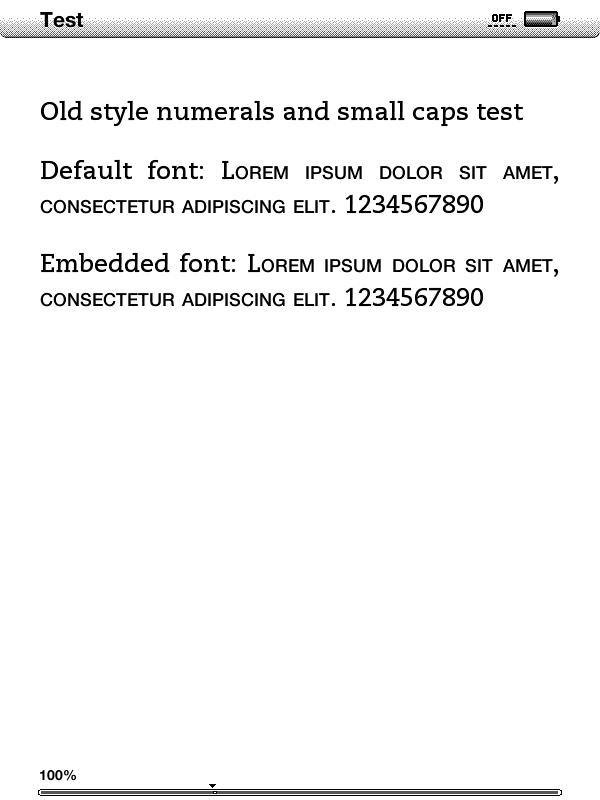

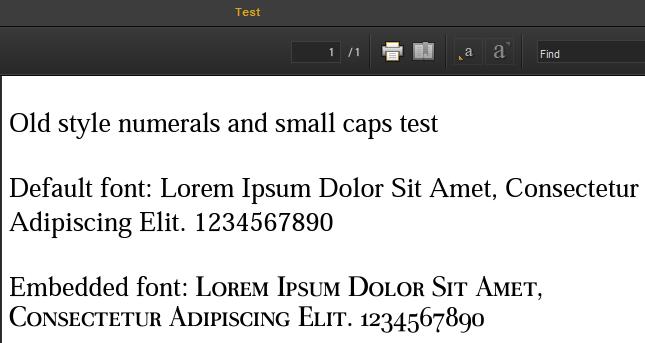

I embedded a subset font* with small caps and old style numerals in an ePub, which displayed fine in Sigil and ADE, but I when compiled it with the latest version of KindleGen, the embedded font seems to be ignored on my K3. (Turning Publisher Fonts on/off had no effect either.)
Is this yet another limitation of the KF8 firmware of my K3 or do eInk Kindles generally not support embedded fonts that replace small caps and/or (old-style) numerals?
[*] a subset font of AnPolt-Regular created with Font Squirrel. (Other subset fonts didn't work either.)

Kindle Previewer shows the Paperwhite displaying the fonts correctly. Has your Kindle Keyboard actually updated to the KF8 firmware?
I note that your screen shot from Adobe Digital Editions shows that they're still not supporting the small-caps attribute, which is in the ePub 2.0 spec. Bad Adobe!

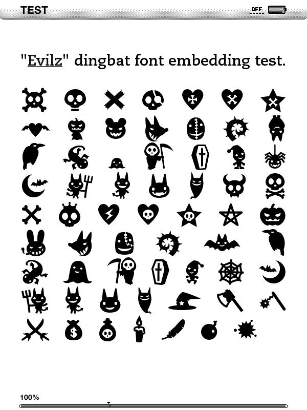

Yes it has and other embedded fonts, for example, dingbats that cover the Latin 1 range, definitely work on my K3.

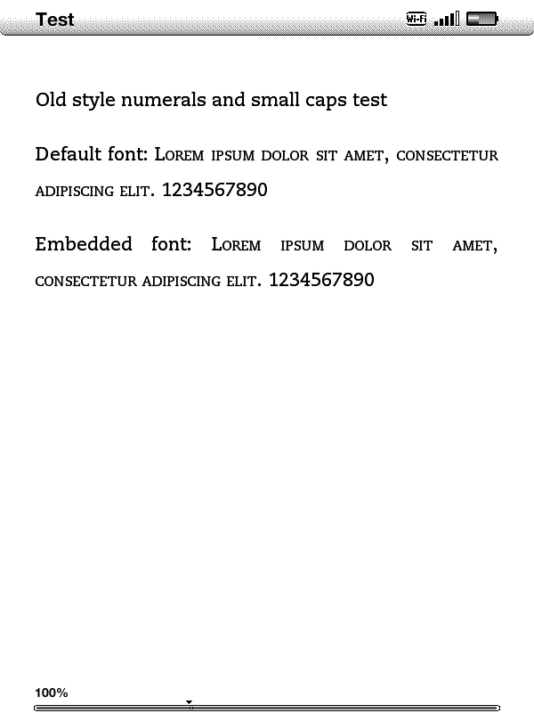

Originally Posted by dgatwood View Post
You may be making it mad by specifying a font variant with a font that does not contain an actual smallcaps OpenType feature. Try taking that out of the CSS and just specify the font itself. Worth a shot, anyway.
I had another look at the file and found out that you were absolutely right on the money. Subsetting the font with FontSquirrel must have removed the smallcaps OpenType feature, essentially converting it to regular font with small caps and old style numerals glyphs.
After removing font-variant: small-caps; from the font declaration and the small caps style everything worked as it should.
