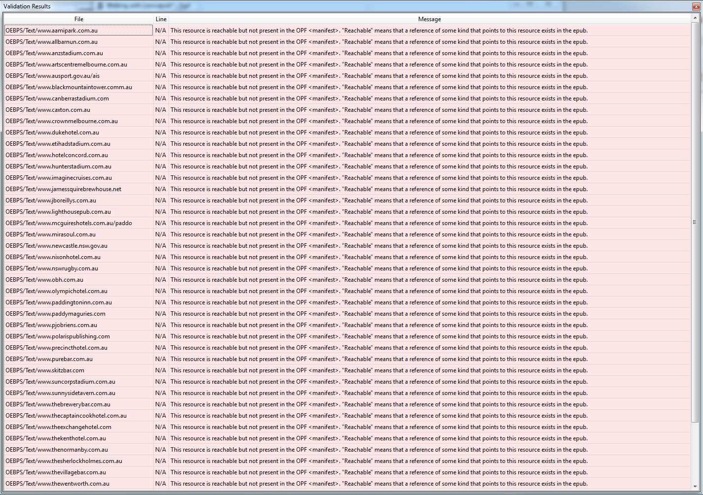

It did, however, throw up another puzzle and I have attached the screenshot. The validation process didn't like the external "a href" links to websites. I know they work since I checked them. Luckily, this didn't affect the Kindle book which looks much better now with lines spaces in situ.
You most likely forgot to prefix the URLs by "http://".

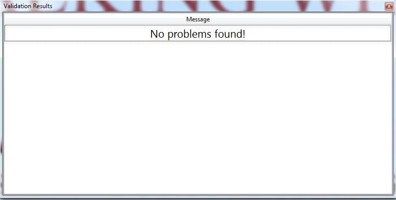

Thanks again, sir. You are correct, I was just being lazy.
Name:	no problems.jpg
