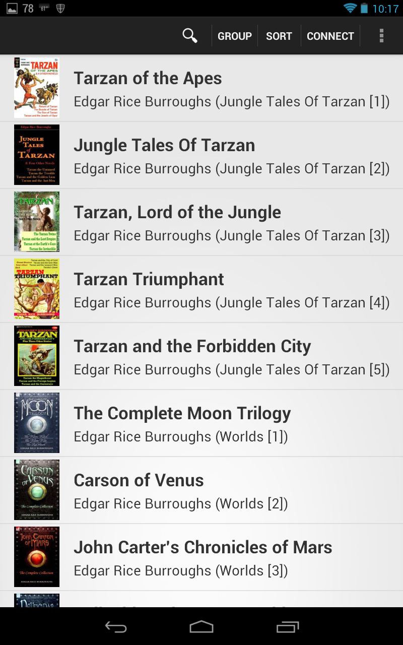

I don't know how plugboards apply to this driver. The default presentation (see attached) of information is exactly the way I had my Sony metadata plugboard setup so I never looked into this possibility of altering it.

Name:	2012-10-27 22.18.00.png
ID:	97303   Click image for larger version
Name:	2012-10-27 22.15.14.png

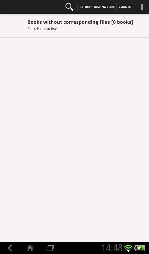

I got the files correctly working now. But you say it has an organizer? How? All I get is a mostly white screen (see screenshot)...
You have selected "Books with missing files" on the settings menu. That screen is showing you that there are no missing books; all the books in CC's database have the corresponding book file.
Tap "back" until you see "Tap "back" again to return to the main display" (should be one tap). Tap back again to get to the settings menu. Tap back once more to get to CC's organizer.

I kept going from that missing book screen to the settings back to the missing book screen... I forced stopped the app and then it opened the book list...
Thanks for letting me know. It will be lots of fun to debug.
