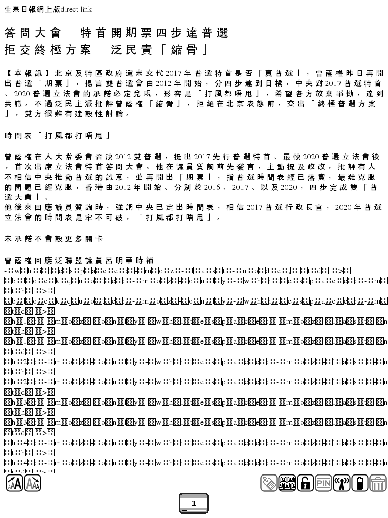

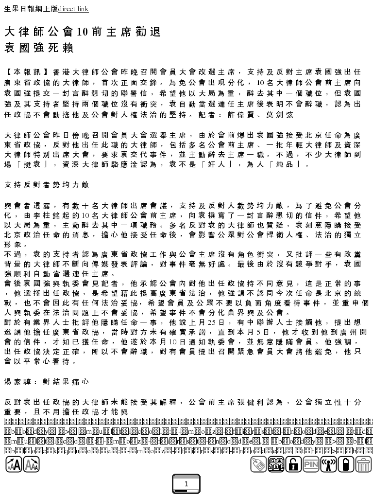

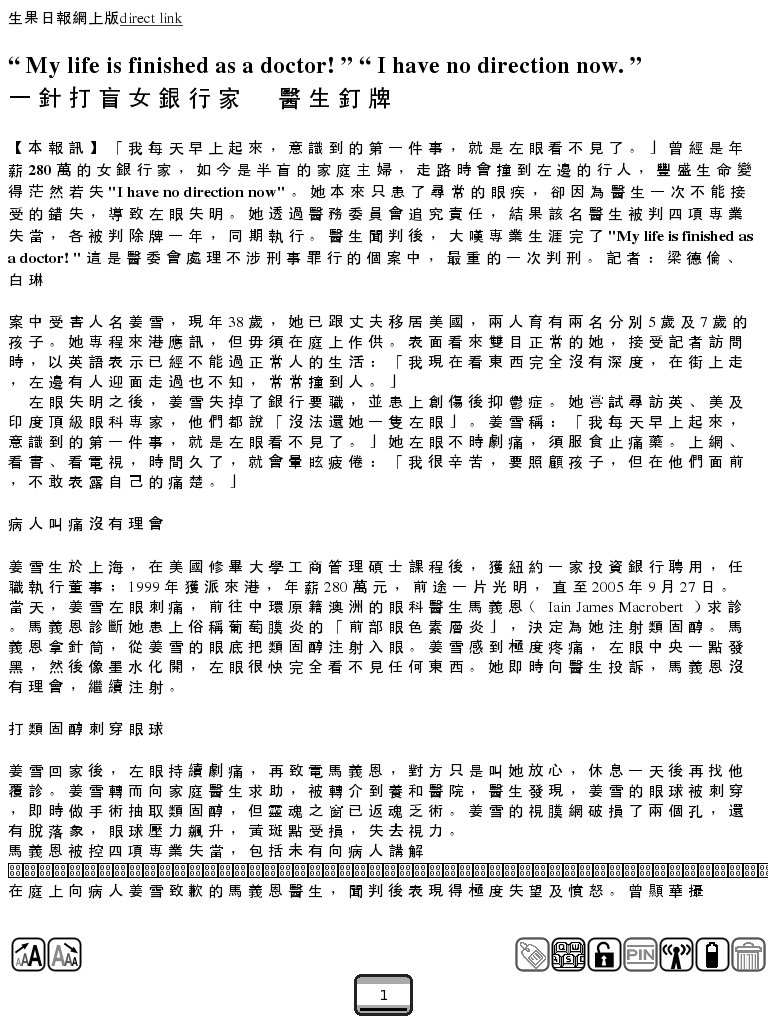

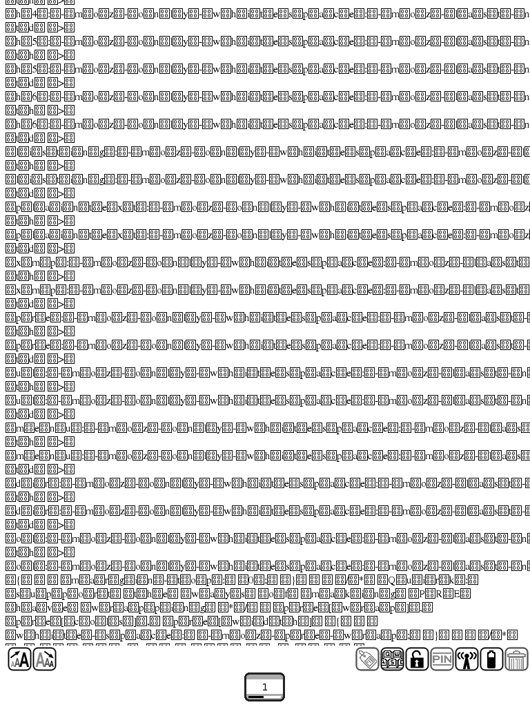

Dear all,
I would like to ask all iLiad friends whether you get this same error?
I would like to program and generate some chinese UTF8 HTML files for daily news reading. I believe iLiad can read UTF8 unicode/chinese HTML files according to the spec.
But I test it and it got random irregular errors.
Some lower part of the HTML pages cannot display properly.
I submitted a case for the technical support. They just told me that this is an font issue and copy some true type font to /root/.font/ directory without providing any detail instruction. I'm quite angry with this kind of support.
Back to the issue, just want to ask any expert for any comment for this issue.
From my IT/ programming knowledge, the chinese characters can be displayed properly for many characters and even in content lister. I tested all files on IE are okay and didn't encounter these funny square fonts...
I believe this is a bug/technical issue on the HTML reader software. If so, iLiad tech support should a fix for this.
Any comment from the community useres and experts?
Many thanks.
Kenny
