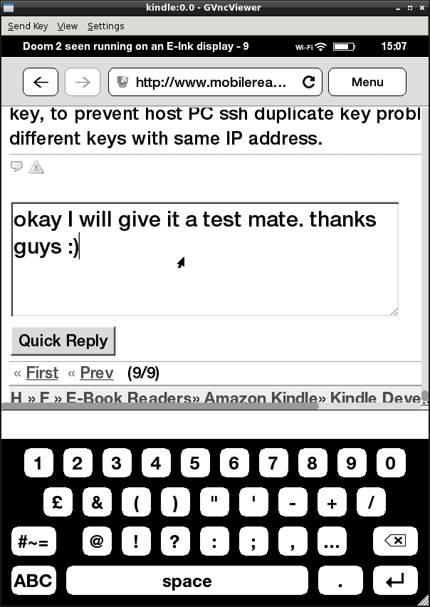

So. Um why might you want this exactly???
well. think of a crazy world where usb devices might actually be pluggable into devices with usb slots.
Like a mouse in say a kindle.
Cursor would be handy at that point.
Or using a vnc client (with no helpful settings) also helpful.
or typing via vnc onto the OSKb (since odd letters are prepended in some clients)

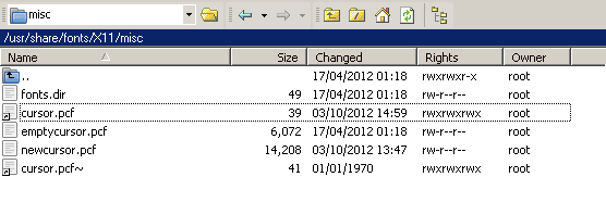

c) splat it in cd /usr/share/fonts/X11/misc/
there is currently a symlink with the FULL PATH to emptycursor.pcf in there...
so
[root@kindle misc]# mntroot rw
scp the newcursor.pcf file to /usr/share/fonts/X11/misc/newcursor.pcf
(or whatever you do for file transfer)
[root@kindle root]# cd /usr/share/fonts/X11/misc/
[root@kindle misc]# ln -sbf /usr/share/fonts/X11/misc/newcursor.pcf cursor.pcf
[root@kindle misc]# mntroot ro
then [root@kindle misc]# killall Xorg
to see the new stuff load with a shiny cursor (left_ptr by default I think)

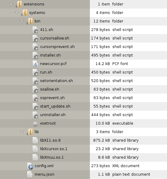

I'll attach:
cursor.bdf (DO NOT PUT THIS ON THE DEVICE, IT'S FOR REFERENCE)
newcursor.pcf - the cursors file
main app: (would live in /mnt/us/usr/bin)
xsetroot - you call this (in this case) to set the cursor with -cursor_name
supporting libs: (would live in /mnt/us/usr/lib)
Shared library: [libXmuu.so.1]
Shared library: [libX11.so.6]
Shared library: [libXcursor.so.1]
Shared library: [libc.so.6]
and maybe "one day" a shell script when I get round to it to run xsetroot with the libs automatically added to the path - OR
simply configure your system as outlined at
http://minimodding.com/article9-Kind...ng-custom-apps
and run [root@kindle upstart]# xsetroot -cursor_name left_ptr like I do.
(I've shoved mine in a startup file)

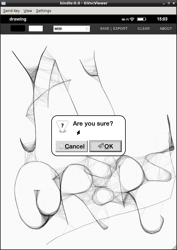

You will also note that applications running vnc now will use the correct icons remotely (gvncviewer we are looking at you) - this benefit could be paired with creating/using a blank icon for the default on the device, thus providing the best of both worlds, no icon on device, icons via vnc.
Other notes:

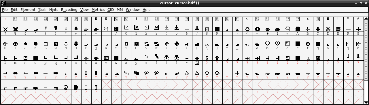

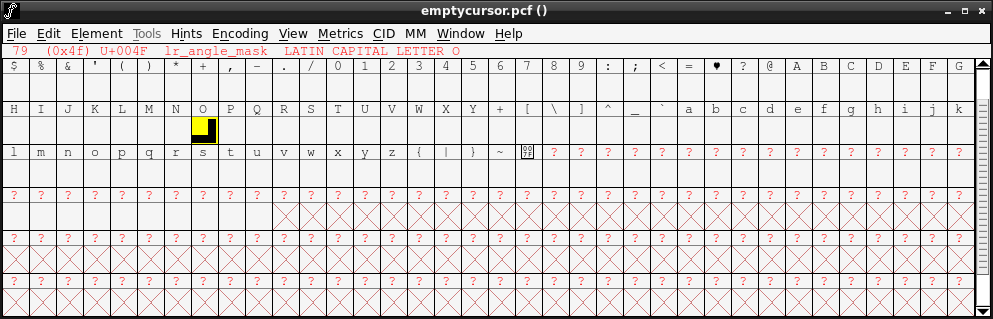

~/Downloads $ grep STARTCHAR ./cursor.bdf
(make me a list of cursors in font)
X_cursor
X_cursor_mask
arrow
arrow_mask
based_arrow_down
based_arrow_down_mask
based_arrow_up
based_arrow_up_mask
boat
boat_mask
bogosity
bogosity_mask
bottom_left_corner
bottom_left_corner_mask
bottom_right_corner
bottom_right_corner_mask
bottom_side
bottom_side_mask
bottom_tee
bottom_tee_mask
box_spiral
box_spiral_mask
center_ptr
center_ptr_mask
circle
circle_mask
clock
clock_mask
coffee_mug
coffee_mug_mask
cross
cross_mask
cross_reverse
cross_reverse_mask
crosshair
crosshair_mask
diamond_cross
diamond_cross_mask
dot
dot_mask
dotbox
dotbox_mask
double_arrow
double_arrow_mask
draft_large
draft_large_mask
draft_small
draft_small_mask
draped_box
draped_box_mask
exchange
exchange_mask
fleur
fleur_mask
gobbler
gobbler_mask
gumby
gumby_mask
hand1
hand1_mask
hand2
hand2_mask
heart
heart_mask
icon
icon_mask
iron_cross
iron_cross_mask
left_ptr
left_ptr_mask
left_side
left_side_mask
left_tee
left_tee_mask
leftbutton
leftbutton_mask
ll_angle
ll_angle_mask
lr_angle
lr_angle_mask
man
man_mask
middlebutton
middlebutton_mask
mouse
mouse_mask
pencil
pencil_mask
pirate
pirate_mask
plus
plus_mask
question_arrow
question_arrow_mask
right_ptr
right_ptr_mask
right_side
right_side_mask
right_tee
right_tee_mask
rightbutton
rightbutton_mask
rtl_logo
rtl_logo_mask
sailboat
sailboat_mask
sb_down_arrow
sb_down_arrow_mask
sb_h_double_arrow
sb_h_double_arrow_mask
sb_left_arrow
sb_left_arrow_mask
sb_right_arrow
sb_right_arrow_mask
sb_up_arrow
sb_up_arrow_mask
sb_v_double_arrow
sb_v_double_arrow_mask
shuttle
shuttle_mask
sizing
sizing_mask
spider
spider_mask
spraycan
spraycan_mask
star
star_mask
target
target_mask
tcross
tcross_mask
top_left_arrow
top_left_arrow_mask
top_left_corner
top_left_corner_mask
top_right_corner
top_right_corner_mask
top_side
top_side_mask
top_tee
top_tee_mask
trek
trek_mask
ul_angle
ul_angle_mask
umbrella
umbrella_mask
ur_angle
ur_angle_mask
watch
watch_mask
xterm
xterm_mask

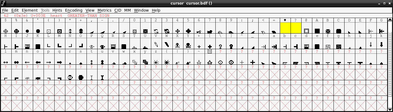

(pictured)
Name:	cursor  cursor.bdf ()_052.png
ID:	93301   Click image for larger version
Name:	emptycursor.pcf ()_068.png
Last edited by twobob; 10-03-2012 at 10:08 PM. Reason: pictures of ...cursors in font

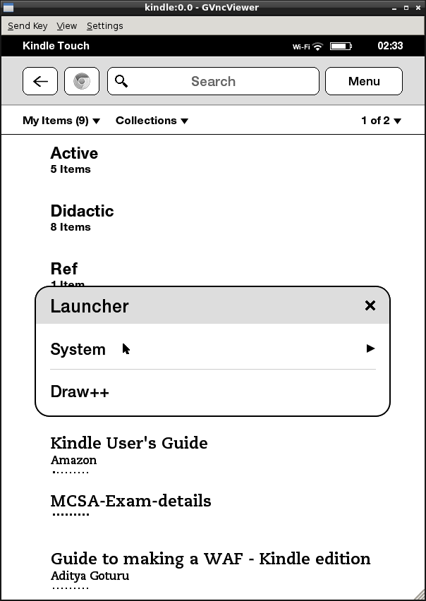

Post

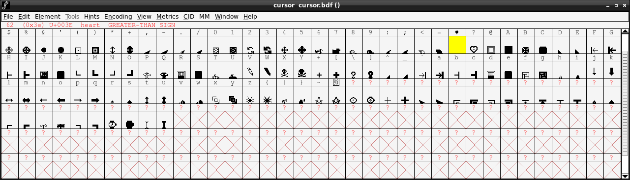

for those of you who would prefer to be able to turn the cursor OFF from time to time...
(or even have it set to off by default) I have created: blankheartcursor.pcf
via:
bdftopcf -o blankheartcursor.pcf cursor.bdf
using an amended ALL BLANK info section for the heart symbol.
which you would call like. xsetroot -cursor_name heart to get a blank cursor.
You could also just do other things:
usage: xsetroot [options]
where options are:
-display <display> or -d <display>
-fg <color> or -foreground <color>
-bg <color> or -background <color>
-rv or -reverse
-help
-def or -default
-name <string>
-cursor <cursor file> <mask file>
-cursor_name <cursor-font name>
-xcf <ARGB cursor file> <cursor size>
-solid <color>
-gray or -grey
-bitmap <filename>
-mod <x> <y>
use a cursor file and swap it for a blank or whatever.
fiddle with the sym link. all sorts, no doubt.
To use this file drop it in the /usr/share/fonts/X11/misc/ folder and link it as outlined before.
killall Xorg to see the new cursors
Few known side-effects:
I left the MASK version as-is in blankheartcursor.pcf so you get a white heart on selected things ahh ^_____^
Other cursors may maliciously now work in various places...
startup screen will have tiny arrow in tree
Also added the blankheartandmaskcursor.pcf for those with something against cute hearts
This however meets my needs.
Thanks.
Name:	cursor  cursor.bdf ()_053.png
ID:	93303   Click image for larger version
ID:	93304   Click image for larger version
Name:	cursor  cursor.bdf ()_055.png

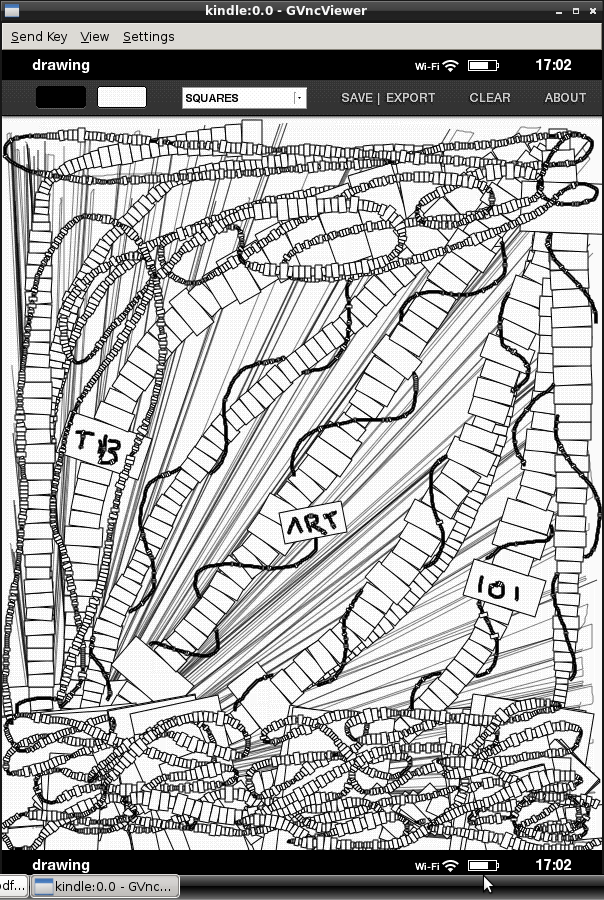

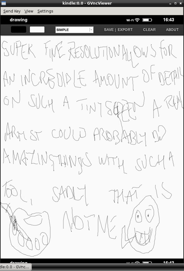

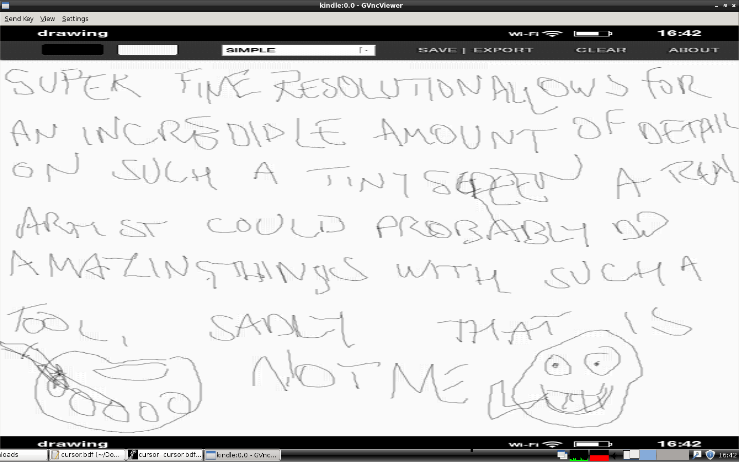

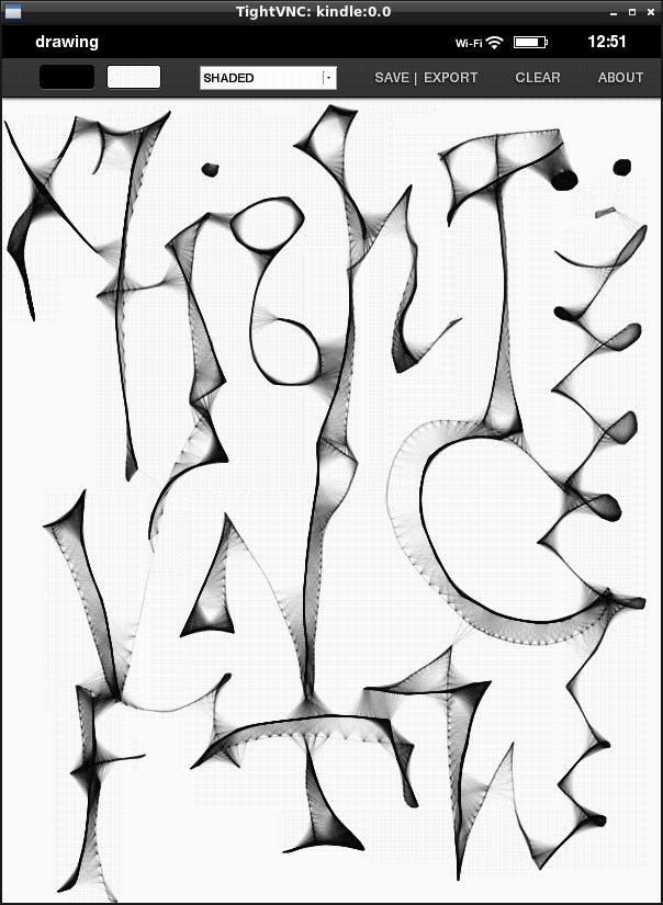

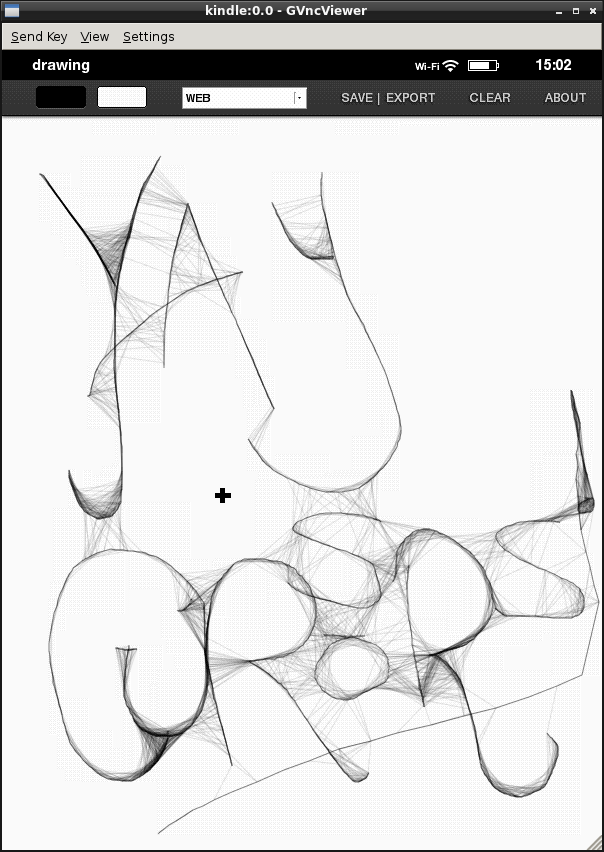

and to the final point of HOW this might be used by an artist...
Install cursors, set the cursor to your preferred cursor, (we could make some precision ones I suppose), load up an enhanced drawing tool (pictured), run via VNC, scale the resolution (I showed 1600 but I could run to 3200), do picture, scale back down.
Amazing details that can be hand touched on the device as you work.
Nice.
HTH someone somewhere.
Name:	kindle:0.0 - GVncViewer_056.png
ID:	93308   Click image for larger version
Name:	kindle:0.0 - GVncViewer_057.png
ID:	93309   Click image for larger version
Name:	TightVNC: kindle:0.0_046.png
ID:	93310   Click image for larger version
Name:	kindle:0.0 - GVncViewer_058.png

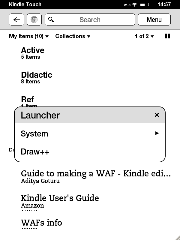

Okay. So to make life a little easier on myself I made a few tweaks a bit easier to access.
It's not JBTweak JBPatch but it does have a few helpful features.
Feature:
  • Run Grayed out installs manually
  • Prevent and Allow Screensaver button
  • Show and Hide Custom cursors (With installer and un-installer)
  • 711 & 411 device info pages.
Simply extract it onto /mnt/us (it goes in the extensions dir) and restart your device.
The installer and the un-installer cause an Xorg restart to pull up the new cursors, this is expected. So save any novels you are writing before doing that
I've splattered some pictures as they are usually more helpful than any amount of words.
First pic: File listing.

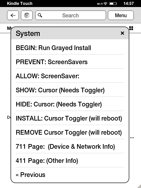

2+3 pic: Demo of thing "alone" with extra "info title data" showing the options that cause an Xorg reboot

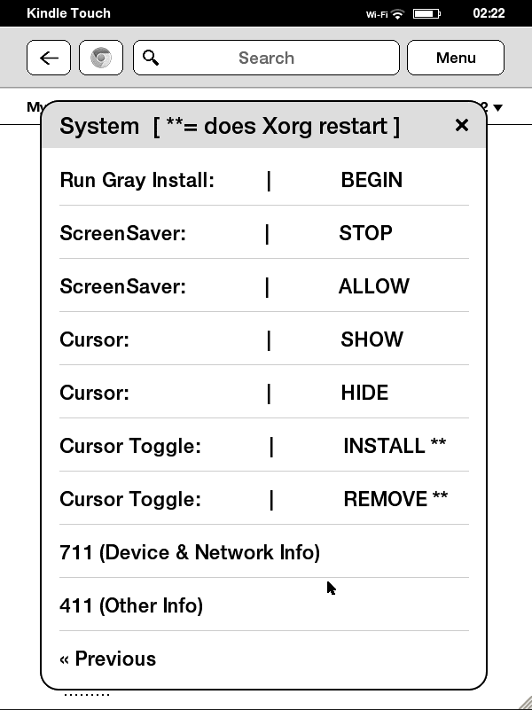

4+5 pic: The actual thingy, as it is.
Well, that's it. enjoy. I took care to test the installer/uninstaller does no harm. Hope it saves you as much time as it saves me.
Cheers.

Great idea, thanks!
I have a few notes though...
First: none of it works out-of-the-box on my device
[root@kindle systemic]# ./bin/411.sh 411
-sh: ./bin/411.sh: not found
You have to save the files in Unix format instead of Windoze format... After converting the files to Unix format, they worked.
Second: I slightly modified the Wiki page to put it where it actually belongs (under GUI Launcher extensions)
Third: this is not a WAF application , but a Launcher extension. WAF apps are "standalone" HTML/JS apps, like Komic. Please do not add to the confusion by using wrong terminology.
Fourth: it's JBPatch, not JBTweak!
Still, great work - keep it up!

a) Thanks, was probably one of the hideous wangles performed by WinScp (I'll have a look at that file)
b) Ah righto, It was late by the time I had done the full rounds, thanks
c) Aye, fair point. technically it did actually start out as a WAF and then became simplified as I realised it could be one liners scripts. "Symstem!k Extensions" it is
d) I know : ) People from the UK clearly should treat the language with more reverence (The rest of the world think us all mad or stupid)
Ah thanks. I'll go check out the file endings.
It was really just a way to push out the little tweaks I use everyday to the general public. Time willing I may work on it. But I doubt it
Thanks mate.
