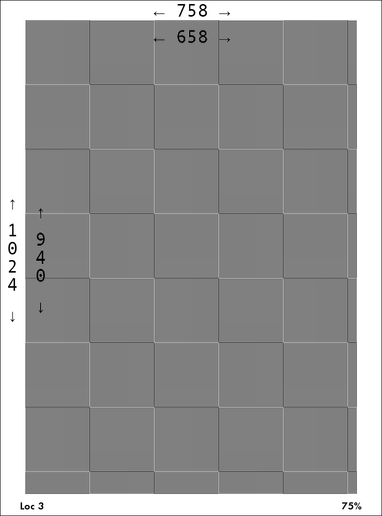

GRiker did some testing to find the optimum image size, the next version of calibre will have a PW output profile (658x940)
Old 10-17-2012, 12:26 PM   #15
GRiker
Comparer of the Ephemeris
GRiker ought to be getting tired of karma fortunes by now.GRiker ought to be getting tired of karma fortunes by now.GRiker ought to be getting tired of karma fortunes by now.GRiker ought to be getting tired of karma fortunes by now.GRiker ought to be getting tired of karma fortunes by now.GRiker ought to be getting tired of karma fortunes by now.GRiker ought to be getting tired of karma fortunes by now.GRiker ought to be getting tired of karma fortunes by now.GRiker ought to be getting tired of karma fortunes by now.GRiker ought to be getting tired of karma fortunes by now.GRiker ought to be getting tired of karma fortunes by now.
Posts: 1,496
Karma: 424697
Device: iPad
Here's the process I used to determine the maximum image size:
  • Create a 1024x768 file with alternating blocks of 1-pixel lines, making it easy to spot resizing anomalies
  • From that file, create a 128x768 horizontal strip and a 1024x128 vertical strip
  • Create an epub with these images in different chapters
  • Compile the epub with Kindle Previewer (or Kindlegen)
  • Transfer the generated .mobi to a connected Kindle /Documents folder
  • Open the .mobi on the Kindle
  • Take a screenshot of each rendered strip (on the PW, touch upper right and lower left corners at the same time)
  • Open each screenshot in an image editor, measure the rendered area
  • Create an image with these dimensions (940x658)
  • Add an image of that size to the epub, recreate the .mobi with Kindle Previewer
  • Confirm lack of resizing anomalies on the Kindle with a magnifying glass
G
