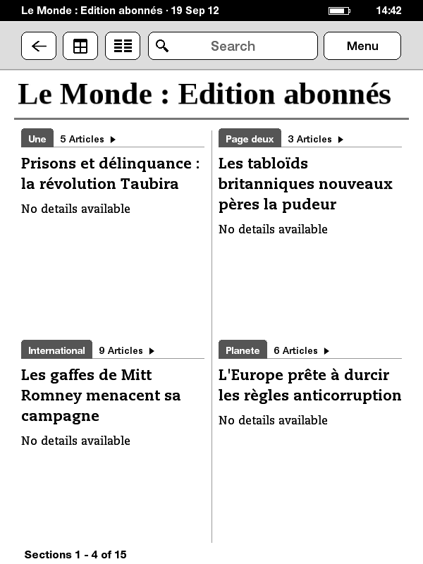

I'm wondering if anyone happens to know if there's a way to populate the 'details' section of the Kindle periodical grid index when writing a recipe.
I've noticed that some recipes do this automatically and others don't, but I can't seem to figure out how to trigger this behaviour for the ones that don't (Le Monde screenshot attached). I personally find the 'details' very useful when deciding whether to read an article or not. Generally, the 'details' are just the first words of the article body.
Any help greatly appreciated.

You have to fill in the description field of the article objects returned from parse_index(), that is used to fill in that area.
If your recipe uses RSS then you would have to implement parse_feeds() and do the same thing.

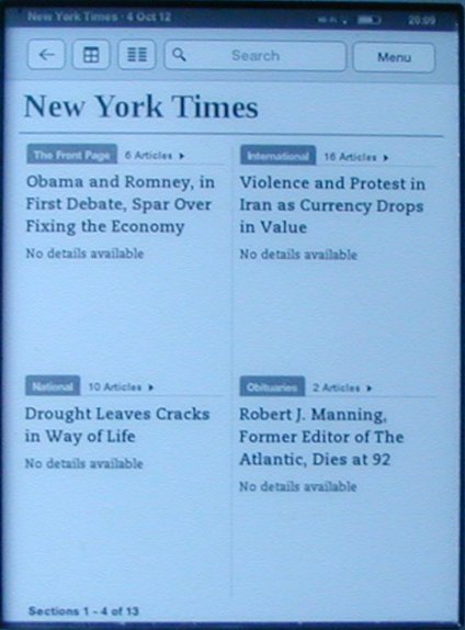

OK there is obviously a different problem then. When I download the NY Times (full recipe that comes with Calibre and needs a username and password) I get this (Kindle Touch):
Am I doing something wrong with the conversion to MOBI? I use all the default settings apart from on the page set up tab where I choose the Kindle as the output profile.

I ran the standard ny times recipe from the latest calibre and all the summaries and thumbnail photos are there, so I can only assume your edition of calibre is way out of date.

I did look at the file you posted and it was lacking the descriptions and thumbnail photos, so I guessed you were using an old version of calibre. If you generated that with calibre there is something wrong with your recipe or installation because it works for me.
EDIT: I just loaded your mobi again and I see it has the redundant "Next | Section Menu | Main Menu | Previous" navigation at the top of the first page of each article. This means you didn't have the output profile set to Kindle because if you did that navigation bar wouldn't be there. So I suggest you make sure your output profile is set to Kindle and try again (although I'm not aware of any differences the profile determines except the removal of this redundant navigation)

I tried Calibre on my laptop which had preferences set for the preffered output format set to MOBI and everything was fine- images etc all come through.
When I set that setting on my desktop everything comes through fine.
Many thanks for your help.
