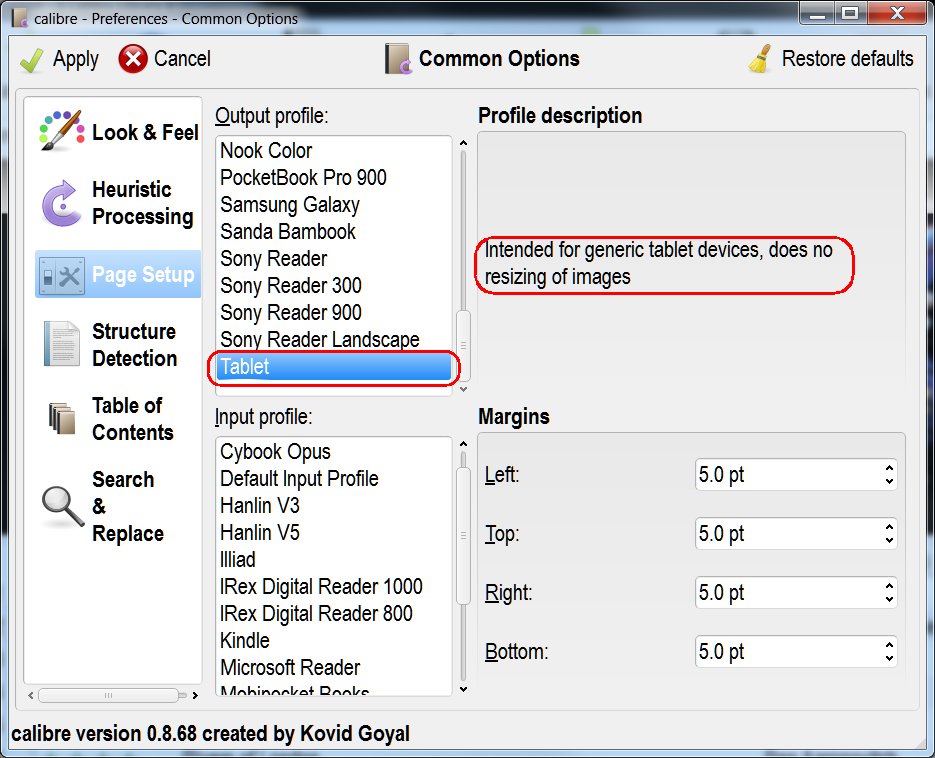

I think your problem stems from calibre resizing your cover during conversion. I believe a way around this is to change your Output profile to Tablet prior to conversion. Then convert the book. See attached.
Yes, agreed. I had problems with Calibre resizing my images when I started using it. Selecting the "Tablet" output option disables image re-sizing.

Would this apply to Calibre v 0.7.28?
The menu structure may look different but if you can find a tablet profile then it should apply.

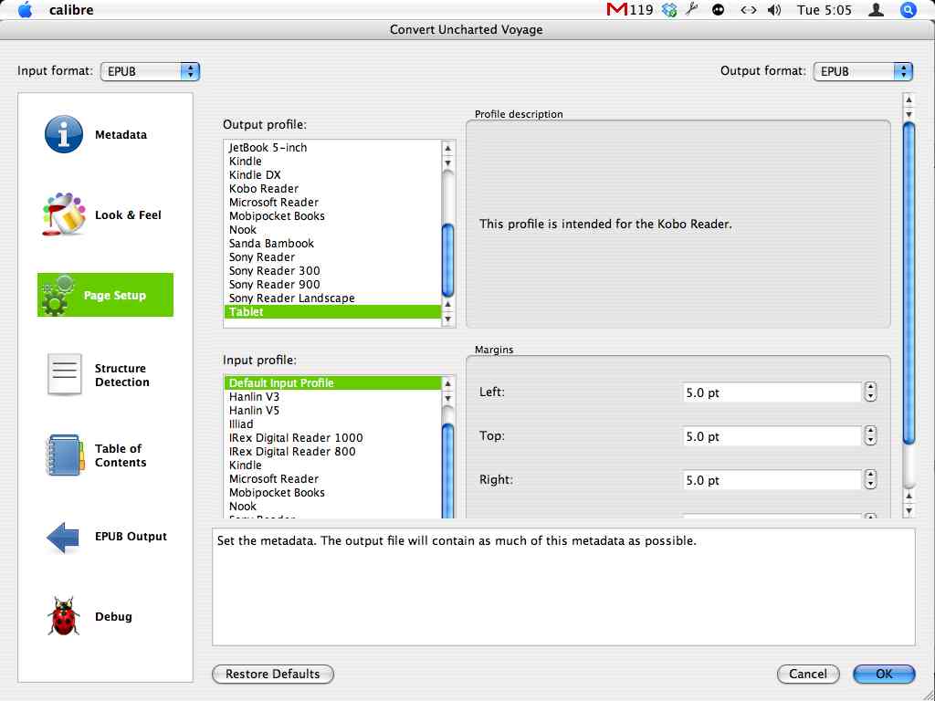

Took me a while to find something. I even went on the web with a search for "a tablet profile in Calibre v. 0.7.28." All I got was my own post and a site:
with an old description of new features in Calibre v 0.7.25 "Add an output profile for generic Tablet devices"
So I went back to your attachment and saw "Page Setup" then "Output Profile" and there in the list is "Tablet Generic." In mine I found "Convert Individually" and that brought up the window with "Page Setup" and Tablet.

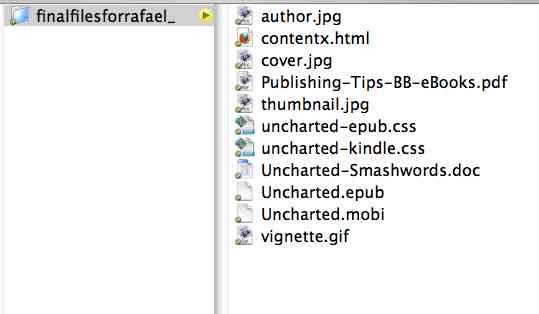

Two of my attachments are images of how I found Tablets. There's one which is the list of files related to my ebook that I got from the formatter.
At this point I have to step back and ask myself just what I'm doing. How much do I really need to involve myself with Calibre and formatting? I do need to get the picture thing fixed, so if pulling in the files and converting them differently will do it, then I need to study up more on that aspect of Calibre.
Do you think it's an easy fix? I notice in the EPUB file that not only do I have the font problem, but the colors have become washed out.
Do the original files remain unchanged in the process of converting/altering them in Calibre?
The css files I don't understand at all. Do I need to deal with them in any of my work with Calibre?

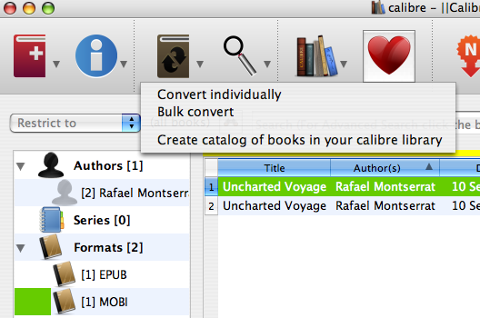

Name:	Convert Books>Convert Individually.png
ID:	92207   Click image for larger version
Name:	Files For My Novel.jpg
ID:	92208   Click image for larger version
Name:	Tablet Located.jpg
That's the spot to check right before you make the conversion.
Should I try Input Profile as Default Input Profile and output Profile as "Tablet"?
That is what I would do.
