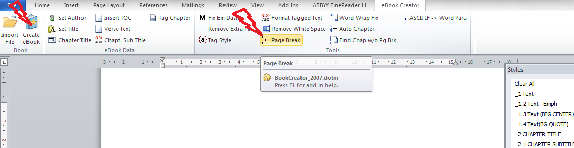

You can use the BookCreator.
you can use a <pagebreak> between each page. then create mobi document inside the Word (it uses Calibre of course )
