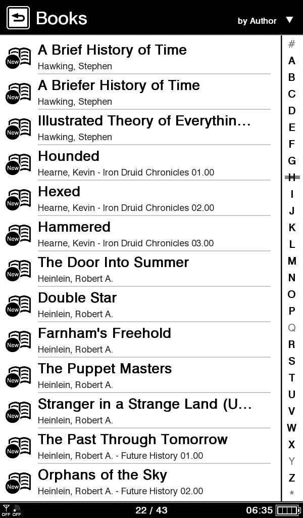

Purchased. Let the fun begin.
Update 1: I'm honored that by default I see a duplicate of my Sony layout, except it looks a lot better on my Nexus 7 with the thumb nails of my books next to each entry. It also allowed me to choose which of the 3 reading apps to use when opening the book to read. Excellent!
You might also notice that if you group by authors then sort by series, you will have something very close to what you described in this post, a list of books by an author ordered by series & series index.

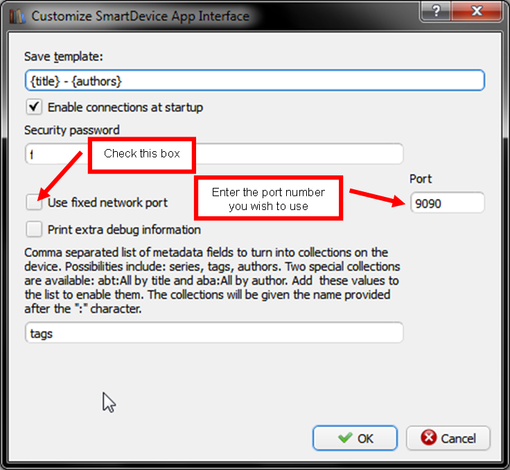

First, the time to sync depends on the number of books on your Tab, which in this case is zero. The connection startup negotiation should finish in seconds. The number of books in your library doesn't affect this.
Now to the problem: You say that the IP and port are correct and that you can open the library with other computers.
First question: when you connect with other computers, what are you connecting to? Calibre's content server?
Second: why did you enter an IP address in the app? Doing so is normally unnecessary. If, however, you have one of the wireless routers that blocks multicast or if you have a firewall on your computer that blocks access port-by-port, then you will need to enter the address and port.
Third: assuming it doesn't work when you enter nothing in the IP box, what port did you use? It must not be the port of the content server. Instead, it should be the port you see in calibre's Smartdevice plugin customization panel. By default, the smartdevice driver uses a random port number. To use a fixed port you must change values in device customization. In calibre, go to the device customization panel for the Smartdevice driver (Preferences -> plugins -> Device interface plugins -> Smartdevice app interface). Check the box "Use a fixed network port". This screenshot shows you the device customization dialog.
Change the default port number (9090) if you wish. Note down the port number you use. Be sure that the port number in the app and in calibre are the same. Also be sure that your firewall is not blocking that port.

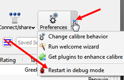

Fourth: assuming that the port numbers are the same and things are still not working, then we need to get some information by running calibre in debug mode. Start calibre, then click the small down arrow next to preferences as shown in this screenshot.
Click on "Start calibre in debug mode". Let calibre restart and answer OK to the dialog that confirms that calibre is in debug mode. Using your Tab, attempt to connect to calibre. Wait at least 30 seconds, then close calibre. You will get a window containing calibre's debug log. Post that debug log here. While you are looking at it, verify that smartdevice interface is starting and that it is using the port you assigned.
When I do these steps, I see the following log (this isn't all of it).

SMART_DEV ( 41.59: 40.437) reset
SMART_DEV ( 41.61: 0.000) set_progress_reporter
SMART_DEV ( 41.64: 0.000) open
SMART_DEV ( 41.66: 0.002) _call_client GET_INITIALIZATION_INFO
SMART_DEV ( 41.80: 0.108) open selected formats [u'epub', u'mobi', u'azw3', u'cbr', u'cbz', u'pdf']
SMART_DEV ( 41.82: 0.000) card_prefix
SMART_DEV ( 41.97: 0.120) set_progress_reporter
Job: 1 Get device information started
SMART_DEV ( 41.99: 0.000) get_device_information
SMART_DEV ( 42.02: 0.001) _call_client GET_DEVICE_INFORMATION
SMART_DEV ( 42.07: 0.020) _call_client SET_CALIBRE_DEVICE_INFO
SMART_DEV ( 42.13: 0.030) card_prefix
SMART_DEV ( 42.16: 0.000) free_space
SMART_DEV ( 42.19: 0.001) _call_client FREE_SPACE
DeviceJob: 1 Get device information done, calling callback
DeviceJob: 1 Get device information callback returned
SMART_DEV ( 42.29: 0.069) set_progress_reporter
Job: 2 Get list of books on device started
SMART_DEV ( 42.31: 0.000) books None
SMART_DEV ( 42.34: 0.001) _call_client GET_BOOK_COUNT
Job: 1 Get device information finished
No details available.
SMART_DEV ( 42.52: 0.158) books carda
SMART_DEV ( 42.55: 0.000) books cardb
DeviceJob: 2 Get list of books on device done, calling callback
DeviceJob: 2 Get list of books on device callback returned
SMART_DEV ( 42.90: 0.319) _call_client NOOP
Job: 2 Get list of books on device finished
SMART_DEV ( 53.04: 10.119) _call_client NOOP
SMART_DEV ( 59.18: 6.105) _call_client NOOP
SMART_DEV ( 59.20: 0.000) _call_client protocol error -- empty json string
SMART_DEV ( 59.23: 0.000) post_yank_cleanup
Last edited by rorschach1234; 08-12-2012 at 02:00 PM. Reason: to add spoiler tags!

It's working now, news that calibre has downloaded according to a schedule I set up is sent automatically and deleted from calibre, all per my wishes. The only difference now is that there are no wires! Purrrr-fect!
My girlfriend and I thank you very much for this wonderful program - now we'll be able to read ebooks with even less hassle than we currently do!
Cheers,
Alan
Excellent. Glad you got it sorted.
I thought that you might have used the content server port because from your description the app clearly connected, but then just as clearly did nothing. The reason that nothing happened is that the app is passive, driven by calibre, while the content server is also passive, driven by the client. Both ends were waiting for the other end to do something that never happened. This will be common enough where we need to find a way in the app to detect connections to a passive somethings that don't speak the protocol. This needs some thought ...

If I could add a feature request, I would suggest allowing CC to sort books into separate folders by author name, as calibre already does, rather than lumping them all into the same folder.
Also, whenever CC is snychronising, it is too easy to click outside the onscreen white box, therefore cancelling the current operation in mid-flow. If there could be a 'cancel' button, but not just by clicking in the wrong spot, that might be a good too.
Cheers,
Alan
rorschach1234 is offline   Reply With Quote
Old 08-13-2012, 03:29 AM   #13
DoctorOhh
US Navy, Retired
DoctorOhh's Avatar
Posts: 9,897
Karma: 13806776
Location: North Carolina
This brings up another question. Kovid mentioned that it would be nice somehow to start transfers from the device instead of from calibre.
I can see folks valuing this ability.
One way to do it would be using the to-come content server interface. You could browse your books using the same interface the app presents for books on the device (to the extent possible), select, and download books. We would support (somehow) an ondevice indication. The advantage of this solution is that the content server exists and is made for this purpose.
The fact that the content server exists is a big plus. Two UIs wouldn't have to be a bad thing if clearly labeled up front as to their function. One Button to enter Local connection a Second button to enter Mobile connection. The mobile connection could be setup to access the Calibre content server and possibly public OPDS catalogs such as Project Gutenberg, Feedbooks, Manybooks (see Moon+ Reader) or even have the ability to add your own catalog so folks could access their books via catalogs setup on their own NAS and not have to have a separate computer running calibre.
Another way to do this would be to permit you to talk to calibre over the device interface instead of the content server. The problem I have is to decide how it works. It is easy to imagine adding the equivalent of calibre's "in library" to our UI -- some sort of checkmark on the display. The more interesting question is showing books that are in the library but not on the device. We would need to show both OnDevice and InLibrary, which isn't hard but will take some thought. However, do you see a list of *all* the books in your library? Does it support searching? Does our grouping interface work? Is any of this possible with reasonable performance?
Good questions. If you could implement something along these lines I'm sure many folks would be very interested. But if you implemented a subset of what you could do with calibre locally, there would always be folks whining about what it can't do and why can't I do this and that... It might be a support nightmare. But it would certainly be a challenge.
Any thoughts? Would accessing calibre when connected as a device be useful? Or is the content server sufficient?
I think using the content server might be best. Any possible support nightmare would be limited by the fact that the content server is a different beast. If you gave it a decent front end with a nice search feature in addition to the new feature to get free books from public OPDS catalogs folks would be very happy. Even the folks that never use the content server would benefit from the possible PD books available. Maybe even have access to Mobileread from this Mobile connection view.
Feature suggestion: When I am in FBReader (not my reader of choice) and select a book I am presented with what essentially is a book jacket similar to what calibre allows you to insert into your book. First the book Cover, then Book Info (grabbed from the metadata) including Title, Author, Series, Series index, Tags, Language and Description. Following this is the path and name of the book as it sits on the Android device.
If you could insert a book jacket similar to this into what you have now, folks would go bananas. They are always looking for a better way to view book info prior to reading. You could eliminate the need for folks to insert books jackets or create catalogs.
If you presented this pseudo book jacket to the user after s/he selects a book, with navigation Read or Back buttons, this would greatly add value to your user. If they choose Read then you have the same pop-up that asks which reader they wish to use. If they choose Back you return them to where they were prior to selecting the book. I believe FBReader creates a temp file in cache to accomplish this feat.
Wish you luck.
