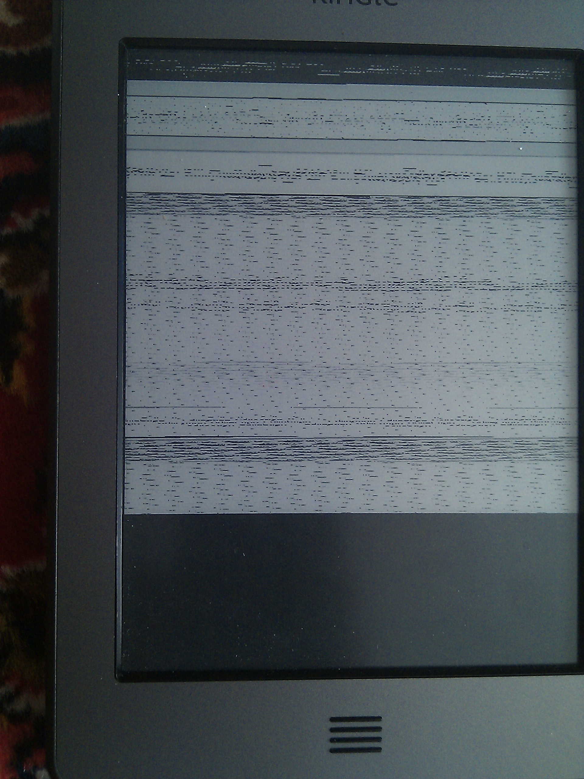

Hey,
I did all steps as you mentioned in the Readme file. But this is what i've got.
All png files in my "Screensaver" folder are 600*800. what should i do?
thnx in advance

Maybe you have installed simple-screensaver, or Your images are not in PNG. Make sure about that.
