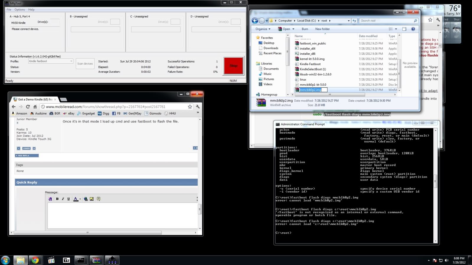

Yea, I downloaded all the necessary files from the sticky thread to flash the stock files. When it got to the point where I needed to flash the file mmcblk0p2.img it told me in CMD that file was not found.
I'm going to try it again in a few minutes.

Just saw I'm on the same page, I'm using the tool to get the kindle into fastboot mode.
Once it's in that mode I load up cmd and use fastboot to flash the file.
(Click to enlarge.)

Nevermind, I foudn the reason, I did a DIR scan of the directory and saw that .img ends with .gz Once I added that to the command it flashed. on to the next step.
