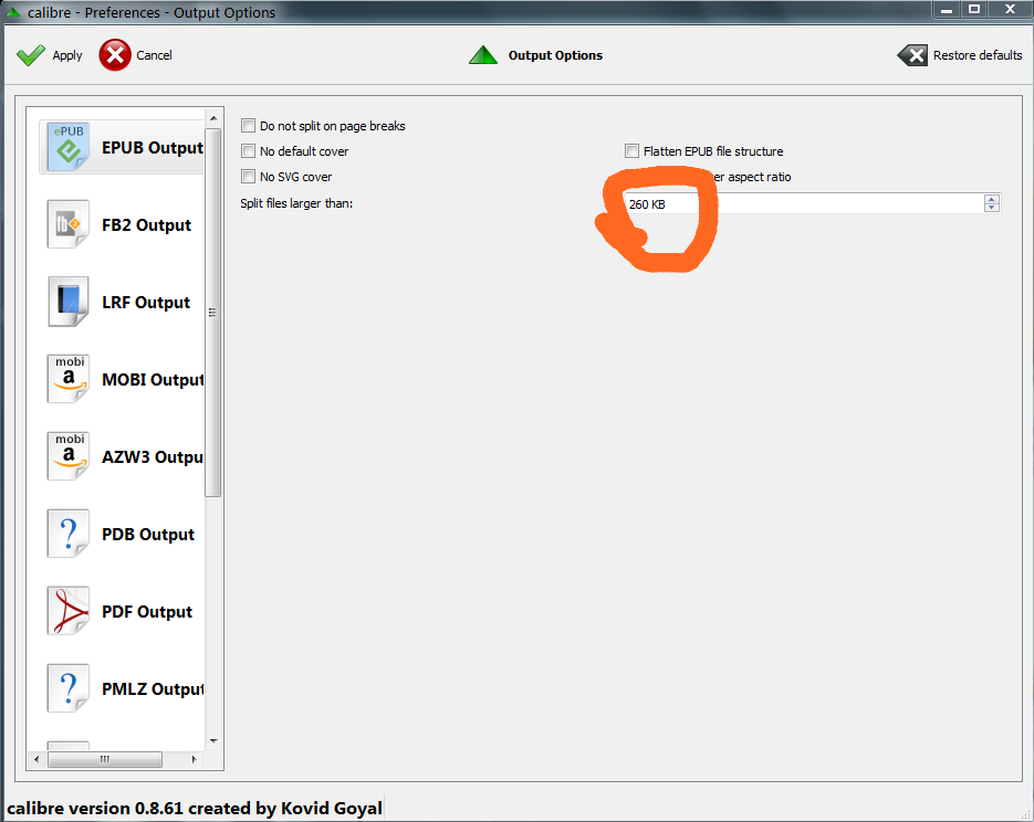

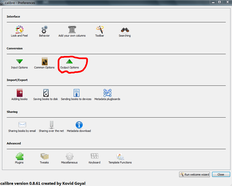

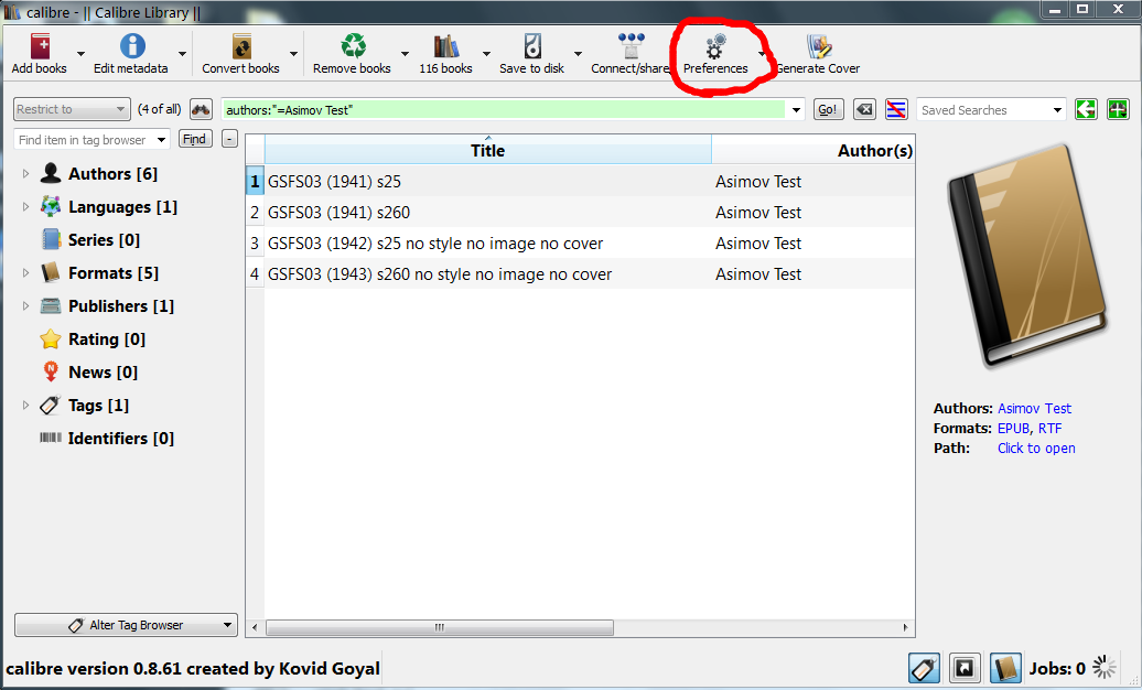

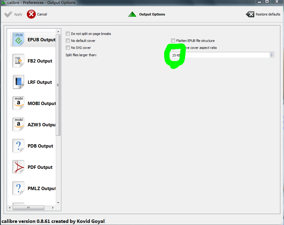

Long story short: if you use Calibre, you need to change a value in the epub output options.
Change the "Split file larger than" parameter from it's default value (260Kb) to the minimum value of 25Kb
I've attached some screenshots that show how to change this parameter.
Backup your library before proceeding further :-)
After changing the "Split file larger than" parameter to 25Kb, you need to regenerate you epub files.
