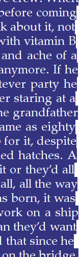

Font-families and justified alignment
I noticed that there are certain font families that both Sigil and Calibre will render with cut-off text on the right margin if you set text alignment to "justify". Palatino Linotype, for instance. Can anyone explain this behavior, and is there a comprehensive list of fonts that have this rendering problem?

Even with a right margin of 1em, justified Palatino Linotype text wanders off the page at the right margin. There's no overflow css being applied (as far as I can tell).

As I said, the problem isn't restricted to Sigil. Calibre also has this rendering problem. Which is precisely why i'm trying to determine the cause: so I can know whether I need to worry about this rendering issue translating to ereaders, and how to avoid it. In any case, I'm not arguing with anyone here—it's not a debate; I'm simply asking a question.
I've attached a sample file. While I was creating the sample, I noticed that when there was only a single paragraph in the document, it rendered without problems. Only when further paragraphs were added did the right-margin go to the dogs.

It doesn't cut off for me (using sigil/calibre in Linux, Palatino font available). The justification looks a bit more ragged than with other fonts, but nothing too out of the ordinary.
Can you post a screenshot of your issue?

I have Palatino Linotype installed on my Windows XP system and your sample epub displays fine with the current stable 32 bit Windows versions of ADE, Calibre and Sigil. What's your system configuration and what Sigil/Calibre versions did you test your epub with? Also check your Qt version by selecting About from Sigil's Help menu.
The only other thing that I noticed that you didn't enclose the font name in quotation marks.
IIRC, font names consisting of multiple words should be enclosed by single or double quotation marks and, as theducks has already pointed out, you didn't specify a fallback font. Your stylesheet contains the following line:
	font-family: Palatino Linotype;
which should read something like:
	font-family: "Palatino Linotype", serif;
I should have spotted that lack of Quotes
