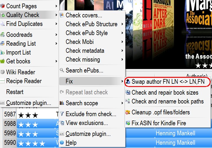

Originally Posted by Lady Fitzgerald View Post
I've got 824 authors in my library that are listed as FN LN, both on the main screen and in the tag broweser. How can I change them to read LN, FN (the way I've always seen it done all my life; I'm 63, btw)? I would die of old age first if I have to do it all manually.
It is kind of an illusion to say you've seen it done LN, FN all your life. Certainly the books in the library and book store have always been sorted on the shelf by LN, FN as calibre also, is by default, sorted by LN, FN. But the books themselves, at least fiction, have always listed the author on the cover FN, LN.
That said everyone is entitled to setup their library the way they are comfortable. Check this section of the manual for more information. After you adjust the tweaks outlined in this section you can install the Quality Check plugin, Preferences - Plugins - Get new plugins. After the plugin is installed select the books you want to swap FN, LN > LN, FN then select the menu item as shown in the attached image. Further info is in the QC plugin help section.
I personally don't alter my library in this manner so more detailed instructions will have to come from someone else.
Good Reading.

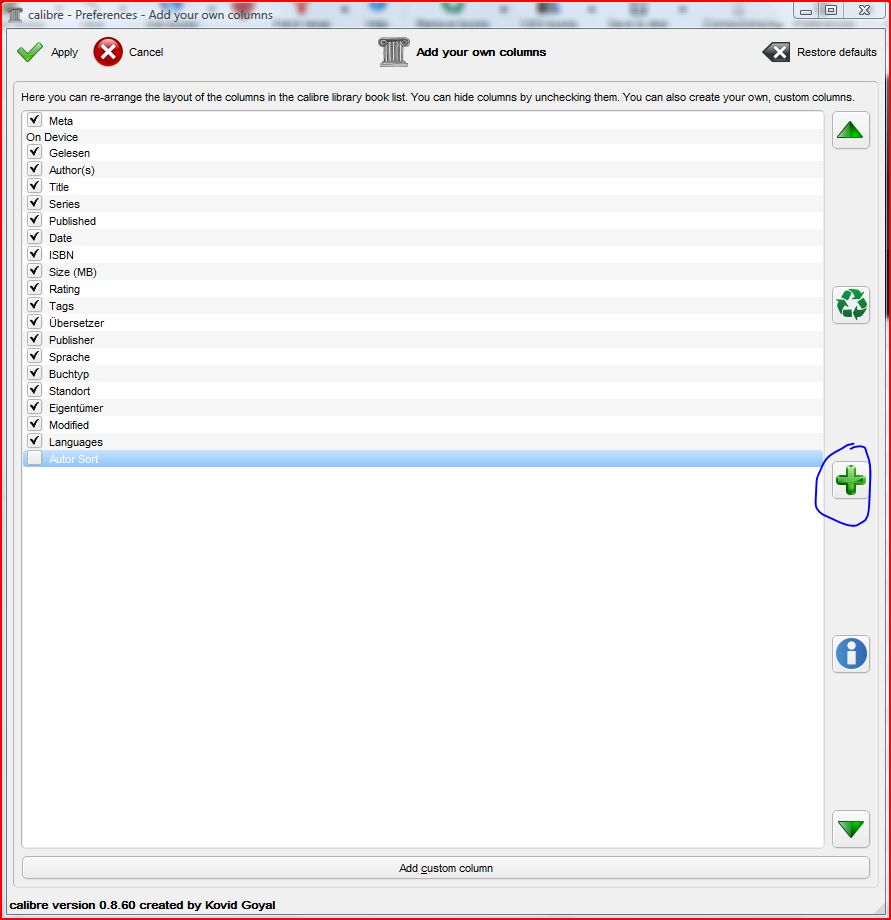

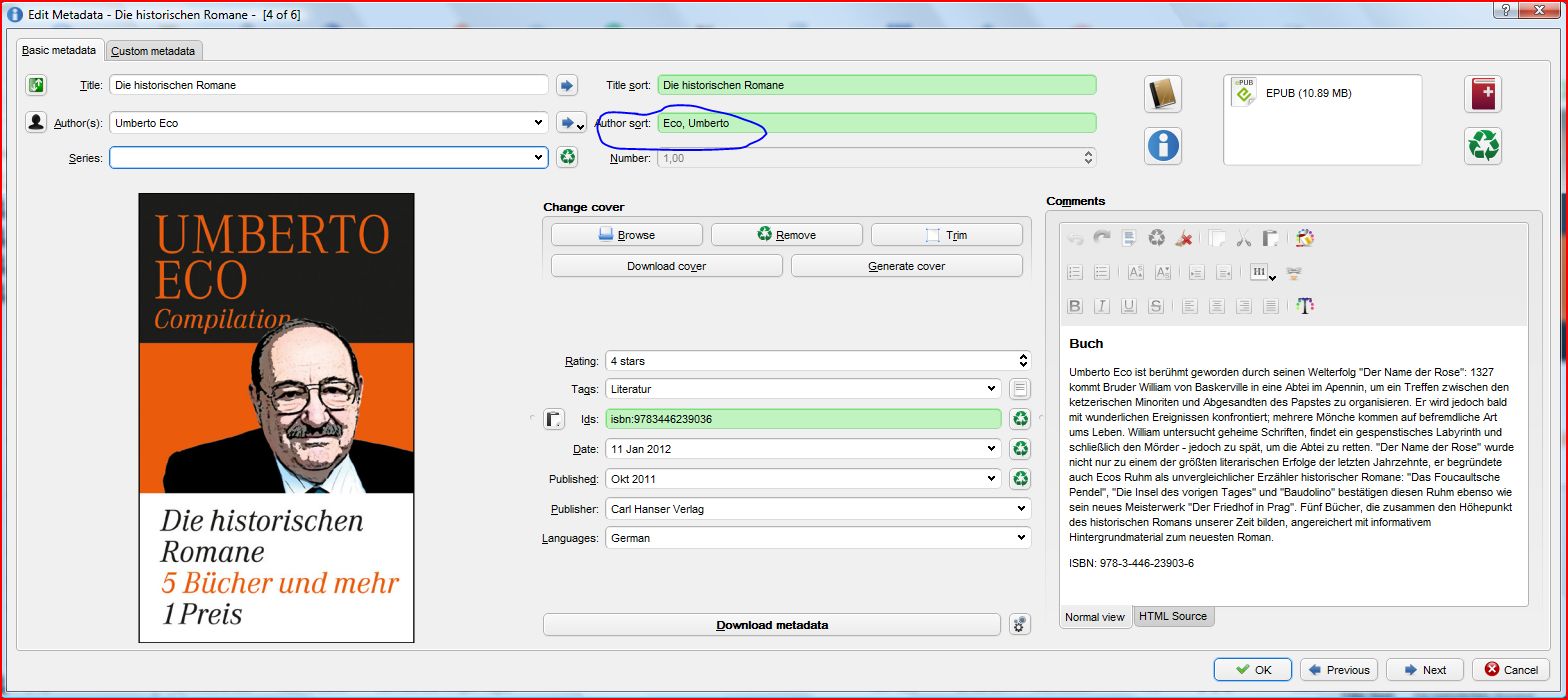

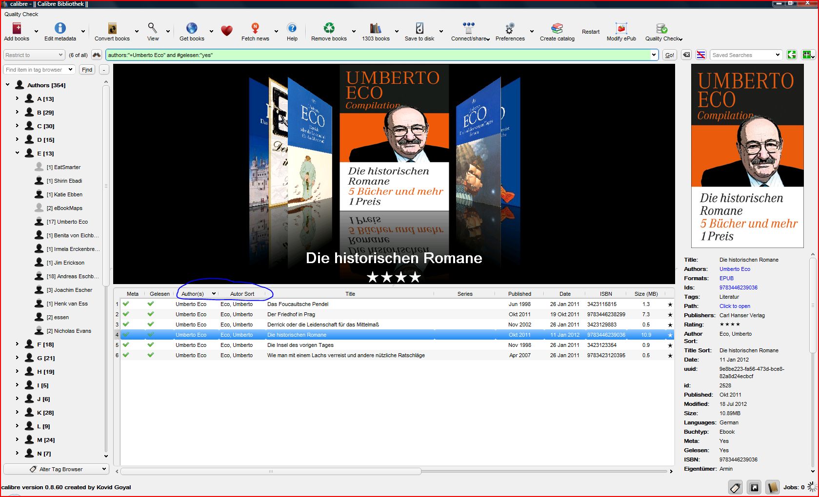

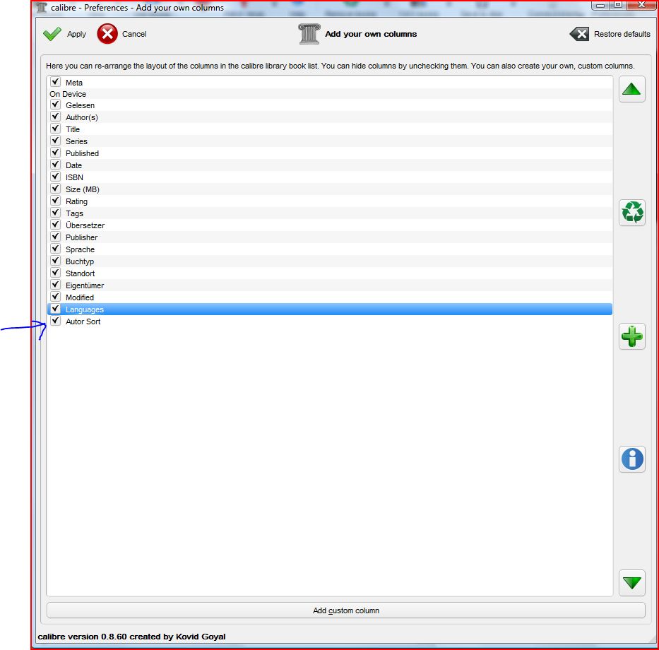

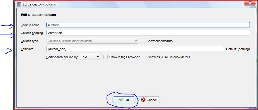

Many ways to find a solution:
I use a custom column what displays the author sort field. This is easy to handle and you have the possibility to use both ways.
How to do:
Preferences -> Interface -> Add your own columns (or right click on an existing column header in Calibre main window book listing and then choose "Add your own columns“ at the end of the listing).
Then click on the green "+" in the right and add a new column (pic1). A small window opens and you need to make the entries as shown as in pic2. You can use own names instead of what I had used. The field "Template" is the important one and this has to be {author_sort}. It represents the book information of author_sort in "Edit metadata"(pic5). After finishing the input save the new column with pressing "ok".
Then you will find a new column "Author Sort" at the end of your list (pic3). You can move the column to another position by selecting the column and then clicking on the green up and down arrow in the right. Click on "Apply" after you move the column to the correct position (window top, left).
When you are back in the main window of Calibre, you can see the new column i.e. like it is in pic4.
You can hide columns you don't want to see by right click at the header of a column and then choose "hide column..."
