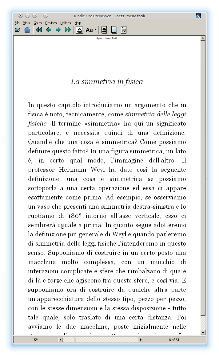

The resulting azw3 file has embedded fonts as seen in Kindle Previewer. See attached screenshot.
Yes, it does. The fonts also display in Kindle for PC. But the Kindle Touch with firmware 5.1 does not acknowledge that the fonts are there if Calibre does the conversion to KF8. But if I use Kindlegen to convert the ePub, then the Kindle Touch does recognize that the fonts exist.

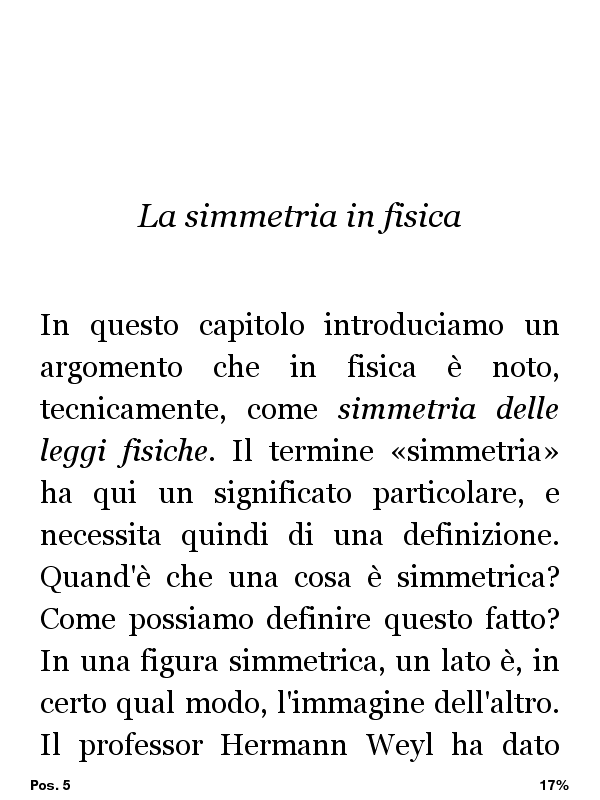

I just tried uploading the two samples converted with kindlegen to the Touch and neither of them showed embedded fonts. So as far as I can tell, the Kindle Touch has no support for embedded fonts
I've attached a screenshot of my sample converted with KindlePreviewer v2.4. You can find the converted sample here.
KindlePreviewer v2.4 should use KindleGen 2.4 (but maybe doesnt?).
The Kindle firmware is the same as your.
P.S. I recall that you have to enable publisher font tapping on the "Aa" icon while reading the book.
pirl8 is offline   Reply With Quote
Old 07-09-2012, 04:38 AM   #14
Posts: 46,618
Karma: 29634066
Your sample.azw3 looks nothing like that on my Touch. What is the firmware version of your Touch? Maybe I need to demand a new Touch from Amazon.
Old 07-09-2012, 04:44 AM   #15
Posts: 46,618
Karma: 29634066
Ah, that's the trick.
