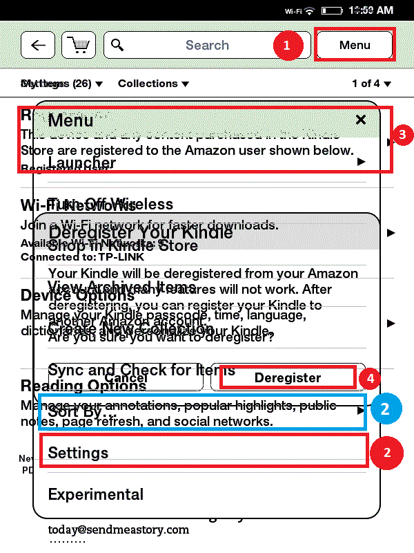

blue 2 is for the Kindle do not have the launcher menu item
red 2 is for the Kindle which have the launcher menu item
BTW this is for Kindle Touch 5.1.0 (You may want to use the one on the post #8 )
I think now it's fixed ?
( Apparently not since the menu is centered vertically the bllue area should be lower a little )
Anyway, the idea still holds. But we need some more screenshots...

Originally Posted by thomass View Post
I forgot about the "launcher"
Attachment 88850
Getting closer. If I was using it I would be VERY tempted to touch the colored circles with the numbers in them. Perhaps they should be moved INSIDE the corresponding touch regions so that touching them will work?
Also, much of the background "noise" can be removed from the printable image. Perhaps just the numbered touch points and a little description of what they do, rather than a screenshot? And perhaps a description to guide choosing which points to touch for their menu layout (or separate printouts for different layouts, for less confusion).
If you stay with the "single template" approach, I would change the SHAPES of the colored circles, so no color printer required. IMHO, of course...

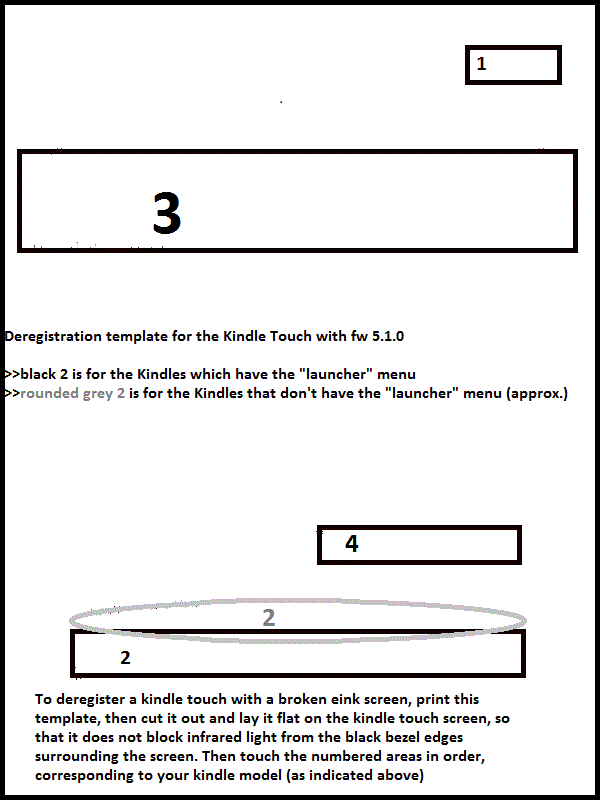

This one is to print
BTW: I'm not sure about the grey 2
Name:	deregistration template for 5.1.0.gif
Attachment 88852
Bad attachment. Clicking it says to notify moderator. I did.
EDIT: Link now good. Must have been a "timing" problem?
That looks much easier to use. Personally, I would add a short description in addition to the "title", such as "To deregister a kindle touch with a broken eink screen, print this template, then cut it out and lay it flat on the kindle touch screen, so that it does not block infrared light from the black bezel edges surrounding the screen. Then touch the numbered areas in order, corresponding to your kindle model (as indicated)." Yes, that is rather wordy, but I find that leaving out details often leads to more confusion. Again, IMHO.
Like most creative design, this is an iterative processes requiring mutliple steps (spread over a sequence of posts here). Anyway, even the first one was a HUGE improvement over previous methods. The refinements just attempt to avoid possible confusion for the broadest audience.
And again, I think that this method is a brilliant idea, and thanks for sharing it.
fixed a small error
I see that my typo (fixed now in my post) made it into your template:
s/you kindle model/your kindle model/
With that placement, I would also change:
s/(as indicated)/(as indicated above)./
Is there any difference in 5.0.x firmware menu layouts? If not, this template may work for them too. To support multiple firmwares, beware of that nasty "airplane" mode menu thing affecting 5.1.1.
Anyway, this solves the problem for this thread. We can modify this for other usages too, hopefully following the template style that has been developed here (or a better one designed by a GUI expert).
