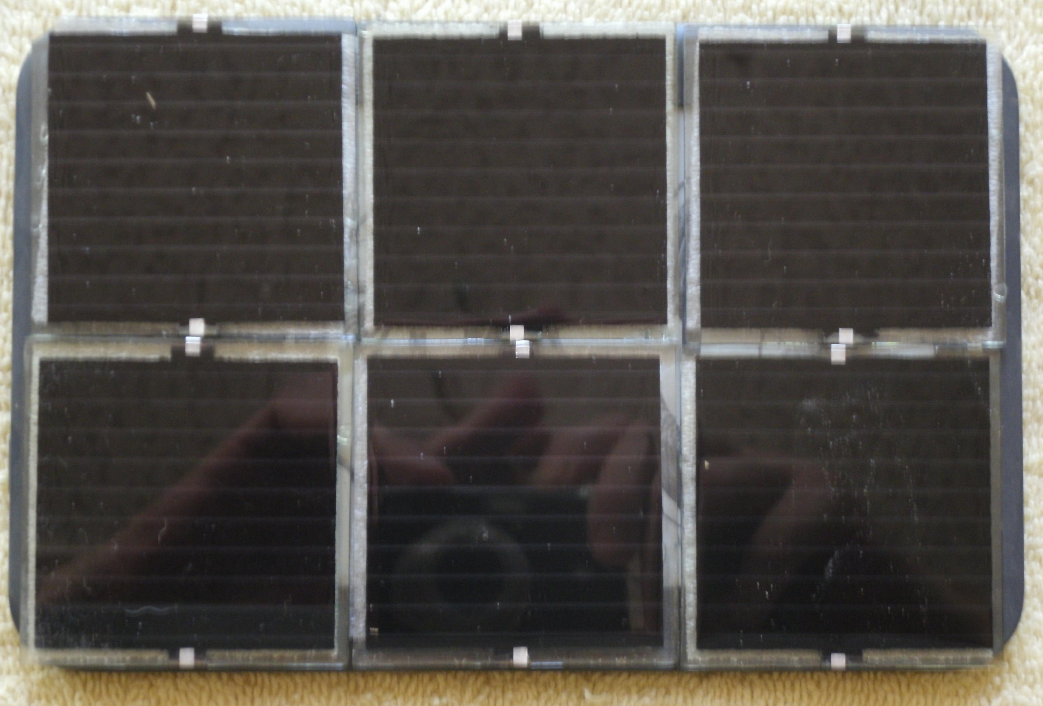

Question 2: Can you get six of these on a Kindle cover?
See image 1, six of the pv cells laying on top of my K3.
Yeah, that could be made to work if the (book)cover (leaf) was a bit wider than the Kindle.

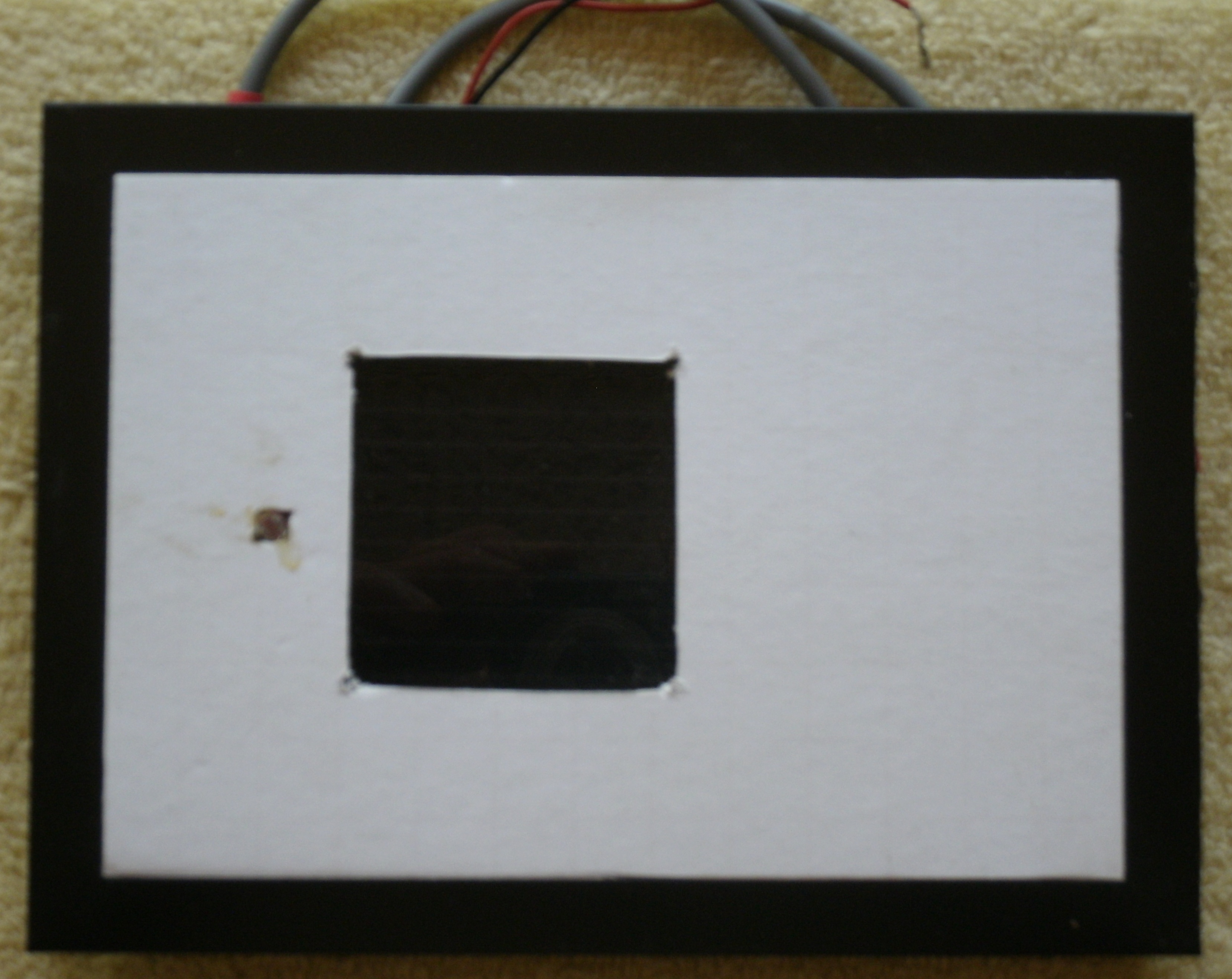

Question 3: How to get the numbers correct in the model for these unspecified pv cells under normal conditions where I live?
See Image 2, one pv cell and one CdS photo-resistor mounted in a test jig.
Plus, not shown, a busy little micro-controller taking measurements.
Link: http://www.microchip.com/stellent/id...cName=en556208
Haven't decided which of the 4 micro-controllers to use yet, probably the 32-bit, MIPS micro-controller. My data-logger-to-be kit.
The test_jig is a photo frame, with hard covered, foam center, "construction board" or "sign board" or whatever your local name for it is in the local craft shop installed, in place of the usual cardboard.
The hard surfaced layer on one side is cut away from the foam center forming a pv cell fitting pocket. (and a hole for the CdS photoresistor).
Do not put the glass back in the photo frame!
It may look clear to your eyes, but it cuts down the output from these pv cells a drastic amount.
The CdS photoresistor provides a measurement of the incident radiance (as a resistance).
The micro-controller will be programmed to characterize the pv cell at various conditions.

The new-to-LTspice user's guide to creating custom components has been extended to include creating custom component Macros.
http://knetconnect.com/ltspice/CustomComponents.html
That should complete that document. Well, other than a bit of editing as the need is discovered.
I will start another set of notes on creating the Mohamed Azab pv cell model.
Why is this OT stuff needed? I thought no one would ever ask
The pv cell parts that a DIY hobbyist is likely to find (surplus, seconds, used, taken out of something broken, etc) will most likely not come with engineering documentation.
The DIY person, with a cheap multimeter, can put their "find" in the bright sunlight and measure the open circuit voltage and the short circuit current.
Ah, but engineering models of a pv cell are based on many other factors than Voc and Isc.
The Azab model requires one other parameter that can be approximated from Voc and Isc - at least close enough for a hobby project.
Plus the DIY person will have to know the active area of the pv cell, which they can measure since it is easily visible. If it isn't visible, the cell will not work very well.
