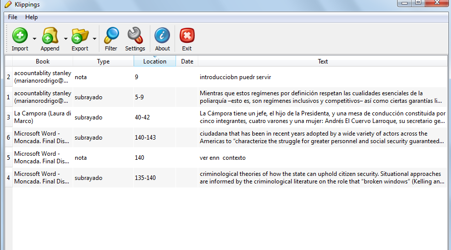

Please try again this app with this settings.txt
Name:	Untitled picture.png
thomass is offline   Reply With Quote
Old 06-16-2012, 12:40 PM   #3
marianormr
marianormr began at the beginning.
Posts: 4
Join Date: Jun 2012
Device: Kindle Touch
I did, it did not work.
version used: win 32
I used Windows 64-bit program firmware works well does not recognize the file.

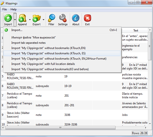

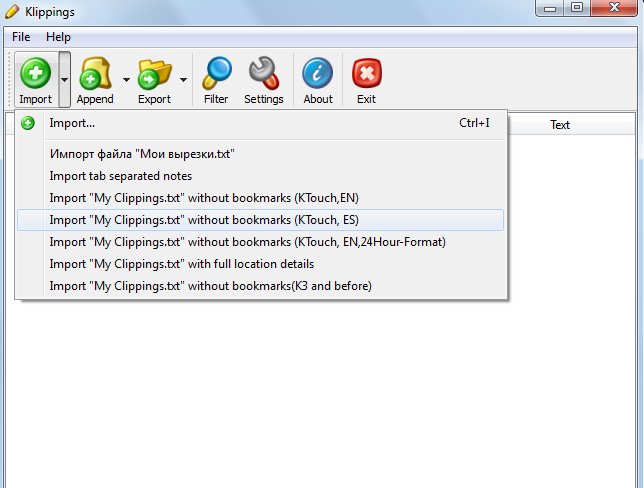

Yes. make sure to replace old settings.txt with this one before running it. with this settings.txt I can add the notes and highlights in your attached MyClippings.txt.
Alternatively, you can modify the current one also. just add this into the appropriate line( anywhere between 5-40 w/o breaking the current structure.)
		"Import \"My Clippings.txt\" without bookmarks (KTouch, ES)": {
			"Pattern": "# Import notes and highlights from \"My Clippings.txt\" and ignore\n# bookmarks. Warnings with information on ignored bookmarks\n# will be added to the log - this is the app normal behaviour\n\n# Note that VERBOSE and UNICODE options are always on\n\n^\\s*                           \t# \n(?P<Book>.*?)                    \t# Book name\n\\s*-\\ Mi\\                    \t#\n(?P<Type>(subrayado|nota))         # Clipping type - 'Highlight' or 'Note'\n.*(Posici\u00f3n|P\u00e1gina)\\                  \t#\n(?P<Location>[\\d-]*)           \t# Location\n.*?A\u00f1adido             \t#\n(?P<Date>(.*))            \t# Date & time\n\\s*                            \t#\n(?P<Text>.*?)                    \t# Text\n\\s*$ \t\t#\t\t",
			"Delimiter": "==========",
			"Extension": "txt",
			"Date Format": "",
			"Encoding": "UTF-8 (all languages)"

Originally Posted by marianormr View Post
bad again
I also tried it : Click image for larger version
Are you sure that you are using this import option to import your MyClippings.txt?:
Import> "Import "My Clippings.txt" without bookmarks (KTouch, ES)"

Old 06-17-2012, 12:36 AM   #8
marianormr
Posts: 4
Join Date: Jun 2012
thank you very much
you are my hero
genius
Originally Posted by thomass View Post
I also tried it : Attachment 87850
