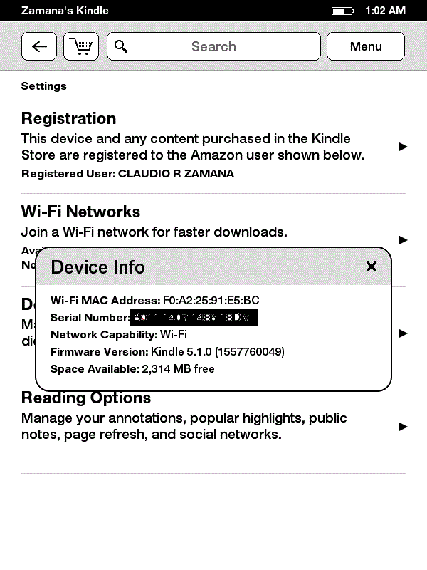

I know that I'm not helping, but my KT, jailbreaked, with only Launcher and usbnetwork installed, didn't updated too.
It raised "Error: 06" when I tried.
My previous (and current) firmware is 5.0.4
UPDATE: It worked! Uninstall all the packages, then uninstall jailbreak, and try again ;-)

Originally Posted by martindolphin View Post
I've just tried uninstalling launcher and removing the Jailbreak - the update then works (...)
Maybe these are the only things people should uninstall to get the upgrade done.
