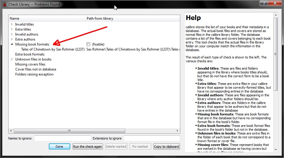

To be sure, you saw a screen like the one shown below, but with the line pointed at by the red arrow having no triangle next to it?

Yes saw that screen and it showed one book that must have been previously deleted, I know I had manually deleted 358 book folders from my Calibre folder was looking out for a big list or a big number. If it was there I struggle to see how I might have missed it.
