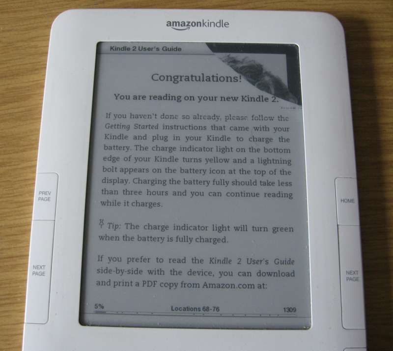

Kindle screen has gone weird
I've got a problelm with my Kindle.
I went to switch it on as usual. It displayed most of the page I was last reading - except for a small area (about 2 square cm) in the top right corner of the screen. This is still showing a fragment of the screen saver that was visible before I switched it on.
Whatever page or menu I now go to, I always see that same bit of Agatha Christie's head in the top-right corner. It's as if the pixels in that area have forgotten how to refresh themselves.
I have tried a full reboot, and also a factory reset, but it makes not difference.
I wonder if anyone else has seen this, or can throw any light on it.
This is a Kindle 2, and is about three years old, so obviously I can't get it fixed under warranty.
Thanks in advance.

It sounds like the glass substrate is cracked. If so, I'm sorry to say that it won't get any better.

Even if it is a hardware/software failure of some kind rather than a broken substrate, the news wouldn't be any better. It's more than likely terminal, regardless. Sorry.

It does sound broken. Can you post a pic?

Unfortunately, Mike, I have to agree with the previous posters that this sounds like a fractured screen substrate. Are you able to take a picture of the screen and upload it? That will tell us for sure.

Thanks for all your replies. At least it's good to know that there's a consensus.
Here is a photo, as requested.

I'm afraid that's an absolutely classic image of a fractured substrate. The fracture is the curved edge of the "frozen" area . Sorry to be the bearer of bad tidings. Looks like it's time for a new Kindle?

That looks terrible! Looks like it is definitely time for a new Kindle. Or, at the least, something that's not broken if something else comes along that suits you better.
