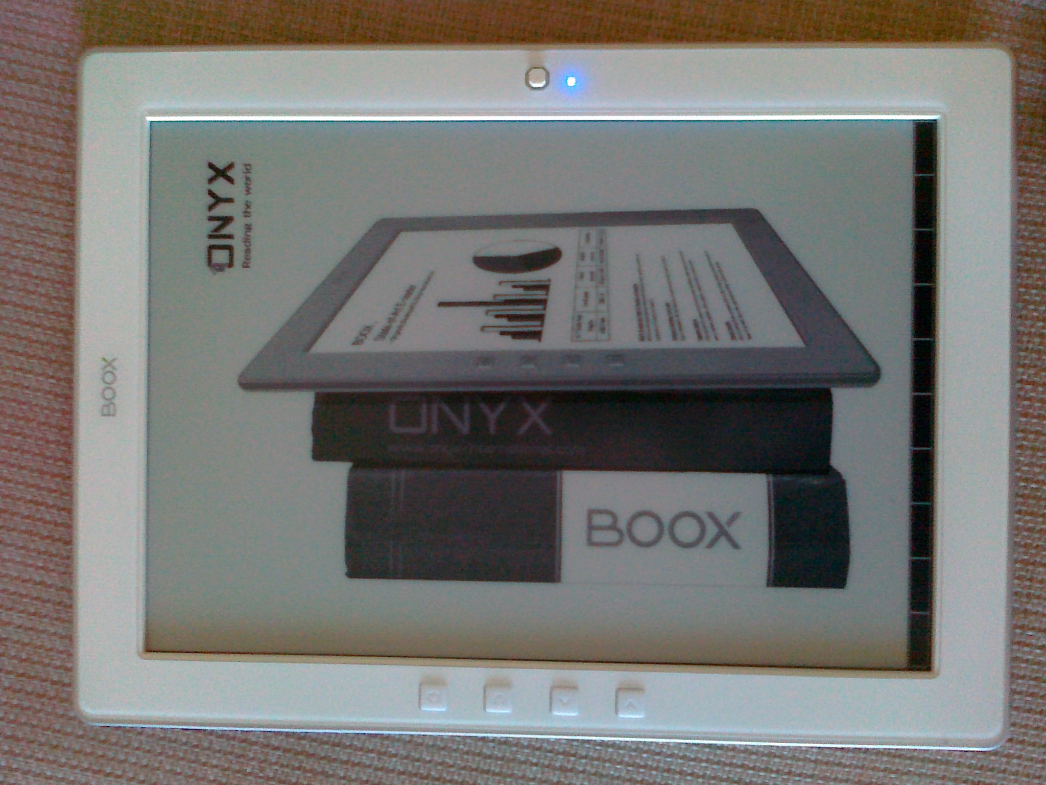

Hello fellow boox users,
I've been using Boox M92 for about a week. Several days ago it failed to boot and I have had no luck bringing it back to life ever since.
I've checked this forum
https://www.mobileread.com/forums/sho...d.php?t=168842
and did the following (without any success):
- reset it many dozen times (through the hole on the back cover);
- updated firmware from original to v1.7 official and 20120224.
Here is the situation (please see attached the picture of the device):
- the boot progress bar (at the bottom of the screen) reaches the end and nothing happens (for many hours);
- the blue LED stays on forever;
- battery is fully charged (did all the manipulations while connected to power as well);
- the reset button works (after the click, the blue LED goes off and i can again power up the device with the On/Off button);
- if i press and hold the On/Off button for some 10 sec or so, the device restarts;
- firmware updates were successful (judging by different wallpaper or screensaver during the boot process);
- on the day before this glitch occured, I installed NewsFlash RSS reader (the program did not work) and used wi-fi connection (successfully). After that i used my boox for a couple of hours without any problems.
Is there any solution to this problem (except flashing the reader with nuclear EMP)?
thanks in advance!

Thanks everyone for your quick replies!
V1.6 taken from here
https://www.mobileread.com/forums/sho...d.php?t=164162
makes no difference.
The firmware gets installed (black screen at the end and the device turns off) but the reader again freezes at the end of the boot progress bar.
My M92 was ordered from Germany in early Feb 2012.
I did another experiment (inspired by a positive solution to a similar problem discussed at
http://www.the-ebook.org/forum/viewt...d1b43124e84be9
I left the device in this frozen state (with LED on) for as long as it took it to completely run out of batteries (rather quick though, about 10 hours). Then fully charged it for about 4 hours. Then did everything from simple start, to reset, to firmware update (with external power supply).
I tried different SD card, but to be honest, I think the likelihood of getting a defective reader should be much higher than getting a bad SD card these days (Transcend and SanDisk cards have become pretty much commodities...).
Formatting the cards differently – FAT, FAT32 (the reader does not recognize NTFS-formatted card) did not help either.
Any ideas? I think I am getting ready to see what’s inside…
By the way, how come v1.6 firmware is 190Mb and v1.7 is only ~100Mb?
