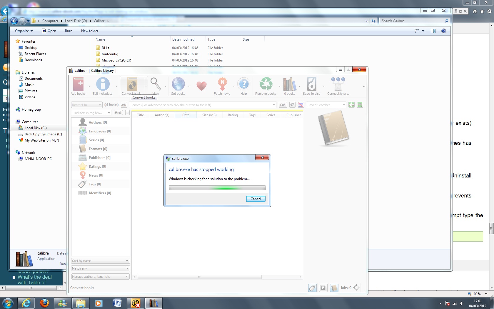

Hi,
I've been trying to get Calibre to work correctly on my computer for a while and I just keep getting the same problem over and over...
The program seemingly installs fine (I've tried downloading the install file through both IE and Firefox with the same end result) and it starts to load up okay, but it'll only work for a second or two before I get the windows error pop up thing that tells me the program has stopped working. It happens every single time and even does the same thing with the debug program when i've tried to run that...
I've installed, uninstalled, rebooted, turned of anti virus and firewall programs, cleared out existing metadata, changed the install locations, etc, but nothing has worked.
I'm running a 32 bit Windows 7 system and i've attached a photo of the error I get... just imagine this 100 or so times over!
Any help would be greatly appreciated before I pull out all my hair or throw various things at my computer!

I found the error report for the problem in the admin tools as you said ilovejedd and i've attached the screenshot... From that it seems like it has a problem with one of the programs dll files
I'll try the safe mode option next!

Somehow, to my mind, a crash in freetype.dll would point to a corrupted font in the Windows font directory.
Maybe try some of the steps listed in http://www.ehow.com/how_6917418_corrupt-fonts.html

I've now tried the program in safe mode and it allowed me to get as far as pressing one button before I got the same error... While this is further than i've gotten before it's still crashing almost straight away, so not helpful!
As for the corruption in the windows font file, i've checked that and it doesn't seem that that is an issue. There does not appear to be any corrupt files there...

Do a checkdisk of your hd--if dose not fix problem also do a root scan with a malware program for rootkits. Malwarebytes works well.
PeterT is right most likely a problem with a font.
