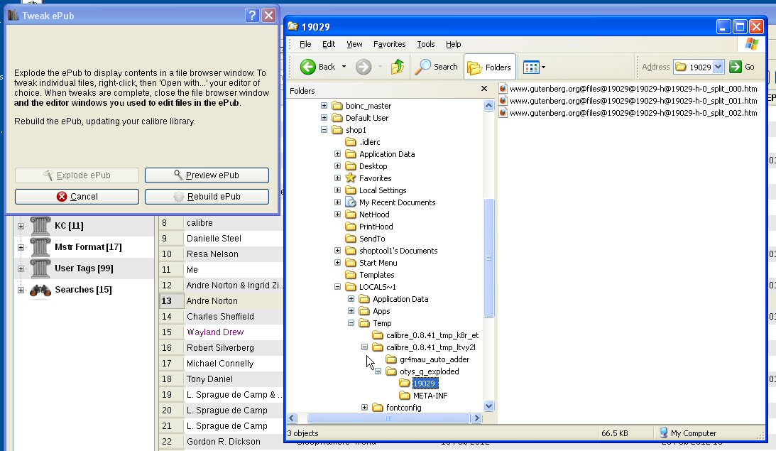

You are not Tweaking the book
This assumes you are only replacing a piece of the whole

Just noticed:
Step 6
Pay attention to the INPUT FORMAT (suggested), Change it if needed to ZIP(HTML are always Zip)
