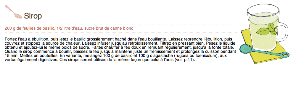

I have a problem with an epub using float div. In attached file, you will see what I obtain in ADE with float positionning. It works fine in iBooks, Firefox, Safari... Is that a bug in ADE or an error from myself...?

What is the coding? Remember, ePUB uses a subset of XHTML and CSS2. It could be that it is neither a bug, nor an error from yourself but that it only works on readers/programs that uses a web renderer instead of a ePUB renderer.

What I mean is that some reading applications, like iBooks, did not bother to create an ePUB rendered which honors the specifications, but used a web-renderer. Although in a lot of cases the result is the same, it is not always the case. This is because the ePUB specifications differ from XHTML and CSS2 specifications. Sometimes this results into unexpected results.
Anyway, I looked at your code and I would actually expect the result you have in your screenshot. So, what did you expect?

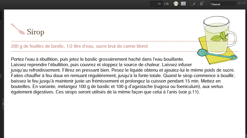

The pink dotted lines come above/overlaps the picture, what I don't want. I expect that the whole div "recette" wraps the image. See screen capture of Sigil.

I guess she(?) expected the dotted borders not be drawn above the image, but to be limited by the floating picture.
I'm not sure that would be the correct behaviour. Floats affect the contents of other elements, but the borders? What the block with a border is higher, should only the top border be reduced? What should happen with the right border if present? One could use the z-index property to ensure the image appears on top of the border, but z-index is not in the ePub spec.

I mean that I don't know how exactly floats and borders are supposed to interact (according to the CSS specification). It might be that what you are seeing in ADE is the correct behaviour, or at least that it is one of the possibilities.
As for a solution, you could try at least placing the <div class="image_right"> inside the <div class="recette">, although I don't expect it to make a difference...

I'm sure you're right about the "interaction" of borders and floats, I made differents tests that seem to confirm this. Unfortunately, placing the div image inside the div recette does not change anything. Thanks a lot anyway for the time you spent responding me Jellby !
As a solution, I put max-width of 60% for the ingredient div, which has the borders, and another max-width of 35% to the image div. It works quite well now.
