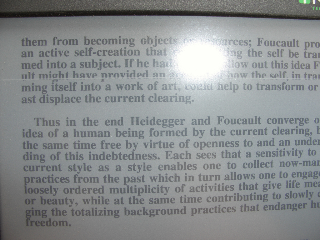

About 11 months into owning my Iliad (which I really liked, despite the fact that newspaper subscriptions never materialized), the screen suddenly developed an odd fault: a single horizontal white line traversing the whole screen near the top. In other words an entire line of pixels stopped flipping white-black as they're supposed to.
I've attached a picture of the fault. (Iliad 00.16.7C.00.OB.E3 closeup.jpg )It was fairly clear to me that this was NOT a problem of the screen being bumped, since a) I've always been careful and b) since it traverses the whole screen in a perfect line, it looks like an electronics problem.

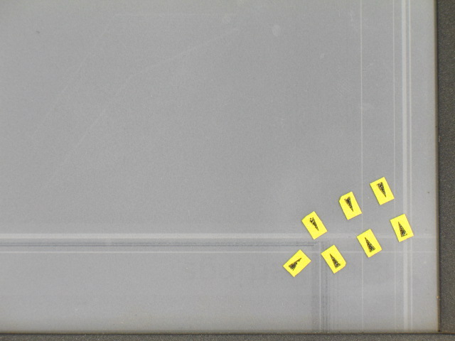

It was surprisingly annoying to read with it, so I returned the Iliad to Irex. Who now tell me that this is somehow the result of a break in the glass substrate due to pressure on the screen. Evidence for which they attach the following picture (bruch2).
Of course the most obvious thing is that the picture in question clearly differs from mine. I guess this is supposed to be the glass substrate underneath after they peel the front of the screen off? I still don't see how the damage shown could possibly have produced the symptom on my screen.
All of this would be sort of irrelevant if they weren't trying to charge me 275 euros for the repair. That's a lot of money. If it was half of that I'd probably just pay after complaining a bit. But instead I am stuck without my Iliad, wondering whether to pay basically the cost of a new reader (from anyone but Irex) to get the thing repaired, when I am kind of doubtful about what they are telling me...

Personally, if the issue is just the one line across the screen, I'd keep my cash in my wallet. It seems to me a waste of money repairing an otherwise working device when new eInk products, with better screens (albeit most are 6"), are coming on the market all the time.
But thats from just an eBook-reader's perspective ~ if you use the iLiad's note-taking etc a lot more then perhaps you might have to. What exactly are the yellow arrows supposed to be highlighting?

For one, I have no idea what they are trying to tell you with those yellow arrows. Secondly I find this pretty poor sort of support. Yes, I understand that a company cannot replace devices that get damaged by improper use. And yes, I understand that iRex might not have the means to be as generous as one would wish.

Since e-ink uses the same type of matrix under the e-ink that LCD screens use and the single line not working is a common problem with LCD screens, it seems that it is not damage caused by the user. What happens is that one of the row capacitors or transistors stops working and keeps the entire row at a constant color.
To my way of thinking it is a manufacturing defect.

The first picture is a line out error (covered within warranty) the second picture looks indeed like there is a crack in the tft layer (not covered within the warranty). I suspect there is maybe a mix up - could you pm me your ticket number via the irex forum -> http://forum.irexnet.com
than i can have a look at it regards
