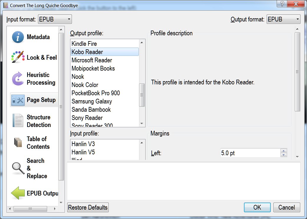

Can you please tell me where I can find the output profile "KOBO Reader" when I look at the output on the upper right hand side of the convert window I get many choices including lit epub zip etc etc but I dont' see Kobo Reader. Do I need to connect my reader before converting?
thanks so much for your help
Kobo reader output profile is under Page Setup, see attached.
Also get there via Preferences - Common Options - Page Setup.
