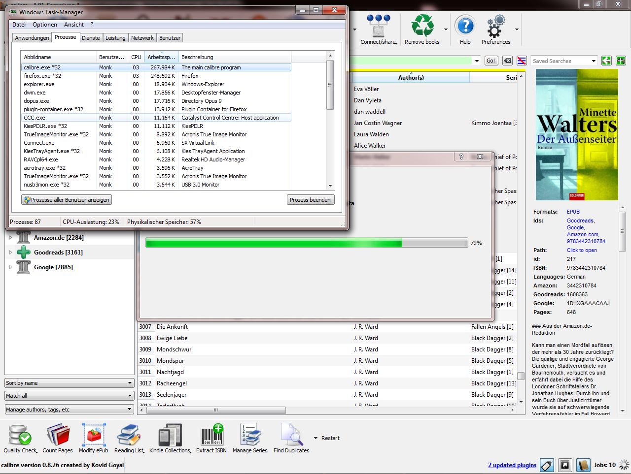

I'm currently trying to repopulate my Tags from Goodreads and thus added like 3600 books to a batch metadata download (only Goodreads as source and only Tags checked).
This attempt completely killed my Windows. Afterwards I tried it in batches of 1000 books. According to the Task-Manager the Calibre Tasks jumps from around 130MB memory footprint to roughly 900MB footprint without releasing the memory after all jobs done.

True, Calibre separtes the 1000 books in 10 jobs. Nevertheless, each job "costs" like 80MB.
Please see the attached screen-shots:
Calibre_10Jobs: Start of the batch, mem footprint ~260MB
Calibre_02Jobs: 8 jobs have finished processing, mem footprint ~850MB
Kind regards

I cannot replicate that, the memory consumption goes down for me after each job completes (each job keeps the downloaded metadata in memory, when it competes the metadata is written to disk and the memory released).
Since this kind of bulk download is typically a one time thing, I suggest you just do it in a couple of batches. I lack the motivation to try to figure out why the mem isn't being released for you.
