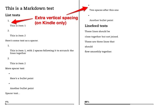

Here's BBEdit 10's preview, which looks fine:

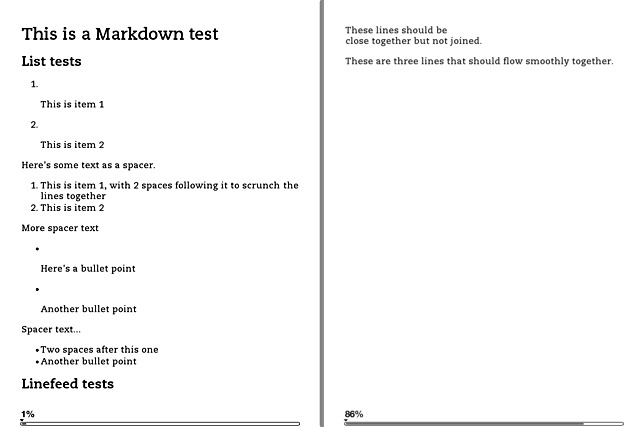

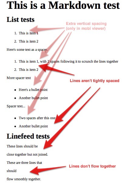

After doing a Txt --> Mobi conversion in calibre, this is what the Mobi viewer shows:
And here's what it looks like on the Kindle 3:
I see these problems:
  1. List items in the converted book get shifted down from their bullets/numbers (on Kindle only)
  2. Line spacing isn't being correctly controlled when 2 spaces are added at the end of the first of two sequential lines
  3. Sequential lines of text aren't being joined together the way Markdown syntax says they should (calibre viewer & Kindle)
  4. (Also, calibre's mobi viewer seems to be adding extra vertical spacing at the top of a list; not quite the same topic though)
Should I officially report these? Or report myself, for lack of knowing what I'm doing?
The images are duplicated below: BBEdit / calibre's mobi viewer / kindle screenshots

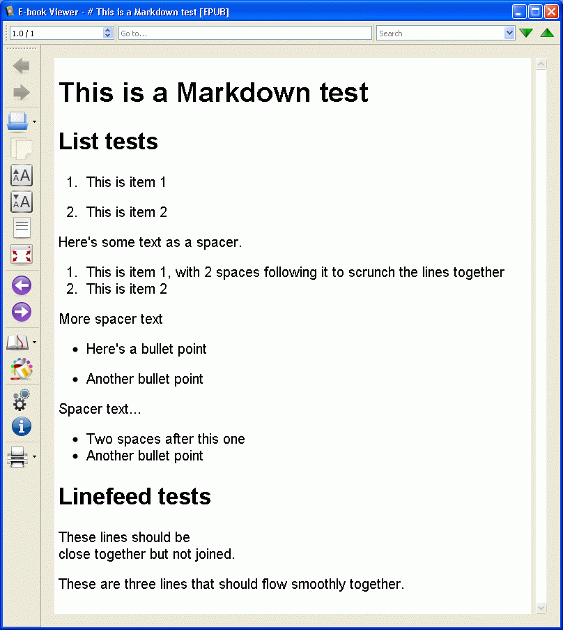

I have taken your example code and converted with calibre, using:
Paragraph style off and Formatting style markdown, and the results look exactly as expected, so it does look like your conversion settings.

Definite progress, so thanks! Still have one issue remaining.
Formatting style was set to Markdown in my TXT Input section, but Paragraph Style was set to auto so it was applying its own rules to the (mostly) otherwise-correct Markdown formatting.
Now when I convert it I get the same correct preview that you got, Agama. But when I actually send it to the Kindle, this is what I get:
The extra vertical spacing remains, but now only for the lists whose members don't have the extra two spaces at the end. Weird. Other than that it's perfect. I don't know what the Kindle (and Kindle Previewer app too) is seeing differently from the calibre mobi previewer.
Calibre doesn't have a Mobi previewer, calibre is an ePub viewer at heart. Everything is essentially converted to ePub prior to being displayed in the calibre viewer.
No idea if it will work, but you might try converting to ePub then Mobi.
Also maybe the folks that refined this section will take a closer look at the mobi conversion and fill us in on what the solution might be.

KindleGen gave the same result as calibre's conversion from ePUb.
But when I edited the calibre-produced HTML to remove the (superfluous?) paragraph tags around the list items, I finally got a good mobi file! It converts correctly whether converted by calibre or KindleGen.
For example, I changed this:
<ol class="calibre3">
<li class="calibre4">
<p class="calibre5">This is item 1</p>
</li>
<p class="calibre5">This is item 2</p>
</li>
</ol>
to this:
<li class="calibre4">This is item 1</li>
<li class="calibre4">This is item 2</li>
</ol>
...and everything worked well. It looks like the paragraph tags on list items is what's messing things up in this case.

I'm not convinced that it's a bug, but possibly a rendering error. If you try the official Markdown test page, (http://daringfireball.net/projects/markdown/dingus) using:
## List tests
1. This is item 1
2. This is item 2
then the output is
<h2>List tests</h2>
<ol>
<li><p>This is item 1</p></li>
<li><p>This is item 2</p></li>
</ol>
Therefore calibre seems to be working in line with the Markdown specification. So before fixing, it may be worth testing that this fix won't cause problems in other rendering systems.
Agama is offline   Reply With Quote
Old 11-09-2011, 02:34 AM   #15
Posts: 46,559
Karma: 29634066
Markdown is supposed to produce <li><p>, as such this is not a bug, but an artifact of the way the Kindle chooses to render <li><p> constructs. Arguably, calibre could compensate, but calibre deals with input from lots of sources not just markdown, so adding a special workaround for this is likely to break other things.
