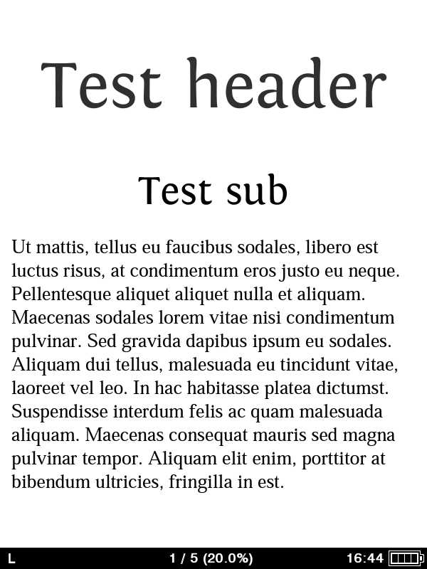

I tried your epub on my PRS650. Both headings are displayed in Fontin and the main body text is displayed in the Sony default serif font. See attached screencap.
