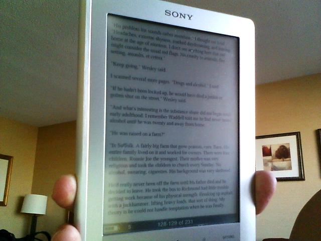

Here's a pic (attached). Unfortunately I have nothing better than the webcam om my laptop..
But the problem is NOT that I cannot charge it. As you see, there's is text on the screen - it displays a page and has done so for the last 4 days. If I plug in the usb-cable, the red light goes on, indicating that it does charge. But that is not what I want. I want it to reboot, and get out of this frozen stage. I don't want to keep reading this one page for ages.
See? It has frozen in a state where it displays one page of text, and I cannot get it to react, not even shut it down.

The fact that a page is showing doesn't mean anything... it takes no power to show a page, only to change it... it is entirely possible to have a page showing like that on a machine with a flat battery and it can only be changed when the machine is charged. The usual fix is to give a long charge, preferably on an external charger overnight but, if you have to charge from a computer then it needs to be left at least overnight whilst ensuring that the computer is not going into sleep mode...

To me it means that the screen is not broken. Always my first concern when an ereader is reportedly "frozen."

I had abosulutely no idea that it could display a page without any battery. And what contributed to that confusion was that it did freeze while I was reading, and by then the battery was charged, so my hunch was that when the battery died, it would shut down the page. But that was not the fact. Interesting..
The way an eInk display works, it needs to reach over and grab power from the battery only when it changes the page. Displaying a page doesn't actually use up any power. Think of it as kinetics or physics: Moving an object requires a certain amount of force. Once said object is firmly in place, you don't need to use any force to keep it there. You do however need to apply force to move it back to the original spot. Same principle. (Sort of, and vastly over simplified. )
