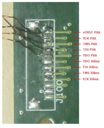

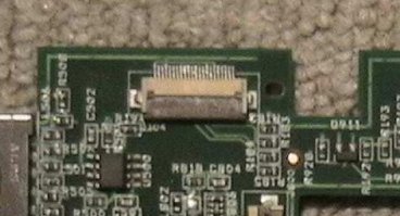

Hi,
Is anyone still interested in the pinout of JTAG on the Iliad? I mapped them out, but still have to verify they work. Just want to see if there is demand. The connector is the one that is not connected at the edge of the board. Actually it is a dual connector that is present on both sides of the board, both with the JTAG pins (also for the Xilinx).
ID:	6483   Click image for larger version
jtag is offline   Reply With Quote

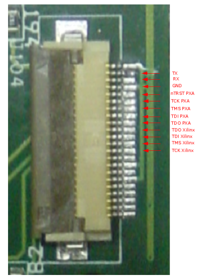

console uart too
Ah ok, I didn't realize the console uart was worth something too. Actually I just found it is also connected to the flat cable connector on the top. I don't have a level converter handy at the moment. Will post details when I confirmed them.
Old 10-23-2007, 06:02 PM   #6
jtag
jtag began at the beginning.
Posts: 3
Karma: 27
Join Date: Oct 2007
Device: irex
pinouts and console output
Attached are two images of the relevant pinouts for JTAG and the console UART. The console UART pins are only available on the front and is configured at 115200 baud.
Console output:

Using /lib/modules/2.4.19-rmk7-pxa2-irex1/kernel/drivers/usb/hal.o
hal_pxa250.c: 1362-hal Initialization Success
Using /lib/modules/2.4.19-rmk7-pxa2-irex1/kernel/drivers/usb/phci.o
td_cache = c022f9f0
ed_cache = c022fa60
usb.c: new USB bus registered, assigned bus number 1
(W)eripc.c:37,erIpcInitServer() Version: 256
hub.c: USB hub found
hub.c: 1 port detected
(W)eripc.c:76,erIpcInitServer() Bound successfully to 127.0.0.1:50072.
USB HAL: HC suspend
usb_phci.c: usb-phci Initialization Success
Using /lib/modules/2.4.19-rmk7-pxa2-irex1/kernel/drivers/scsi/scsi_mod.o
SCSI subsystem driver Revision: 1.00
Using /lib/modules/2.4.19-rmk7-pxa2-irex1/kernel/drivers/usb/storage/usb-storage.o
Initializing USB Mass Storage driver...
usb.c: registered new driver usb-storage
USB Mass Storage support registered.
(CL_W)main.c:217,main() gtk_rc_get_default_files [/etc/gtk-2.0/gtkrc]
(CL_W)main.c:217,main() gtk_rc_get_default_files [/home/root/.gtkrc-2.0]
$** can't synthesize pci hotplug events
AC97: Turning off sound
(W)mb-applet-icon-container.c:1184,loadIcons() Can't find pRegIcon[56]
(W)mb-applet-icon-container.c:1184,loadIcons() Can't find pRegIcon[57]
(W)eripc.c:76,erIpcInitServer() Bound successfully to 127.0.0.1:50065.
(CL_E)erConnect.c:68,erConnectInit() Lock the connect mutex
(CL_E)metadataStoreManager.c:936,recreateArchives( ) Can not create directory /mnt/free/newspapers!
(CL_E)metadataStoreManager.c:947,recreateArchives( ) Can not create directory /mnt/free/books!
(CL_E)metadataStoreManager.c:958,recreateArchives( ) Can not create directory /mnt/free/documents!
(CL_E)metadataStoreManager.c:969,recreateArchives( ) Can not create directory /mnt/free/notes!
(W)eripc.c:76,erIpcInitServer() Bound successfully to 127.0.0.1:50070.
(CL_W)programManager.c:1019,pm_InitProgramTable() Application [APABIMOBI] executable [/usr/bin/xebreader] is not found: disabled it
(CL_W)programManager.c:1019,pm_InitProgramTable() Application [EBA] executable [/usr/bin/eba] is not found: disabled it
(CL_W)programManager.c:1019,pm_InitProgramTable() Application [ARINC] executable [/usr/bin/ereader_mapviewer] is not found: disabled it
$** can't synthesize root hub events
Using /lib/modules/2.4.19-rmk7-pxa2-irex1/kernel/drivers/usb/pdc.o
USB HAL: DC suspend
usb_pdc.c: usb-pdc Initialization Success
Using /lib/modules/2.4.19-rmk7-pxa2-irex1/kernel/drivers/usb/mscd.o
pdc_bus.c: Registered Driver devmscd
devmscd.c: devmscd Initialization Success
OpenEmbedded Linux ereader ttyS2
ereader login:
ID:	6713   Click image for larger version
