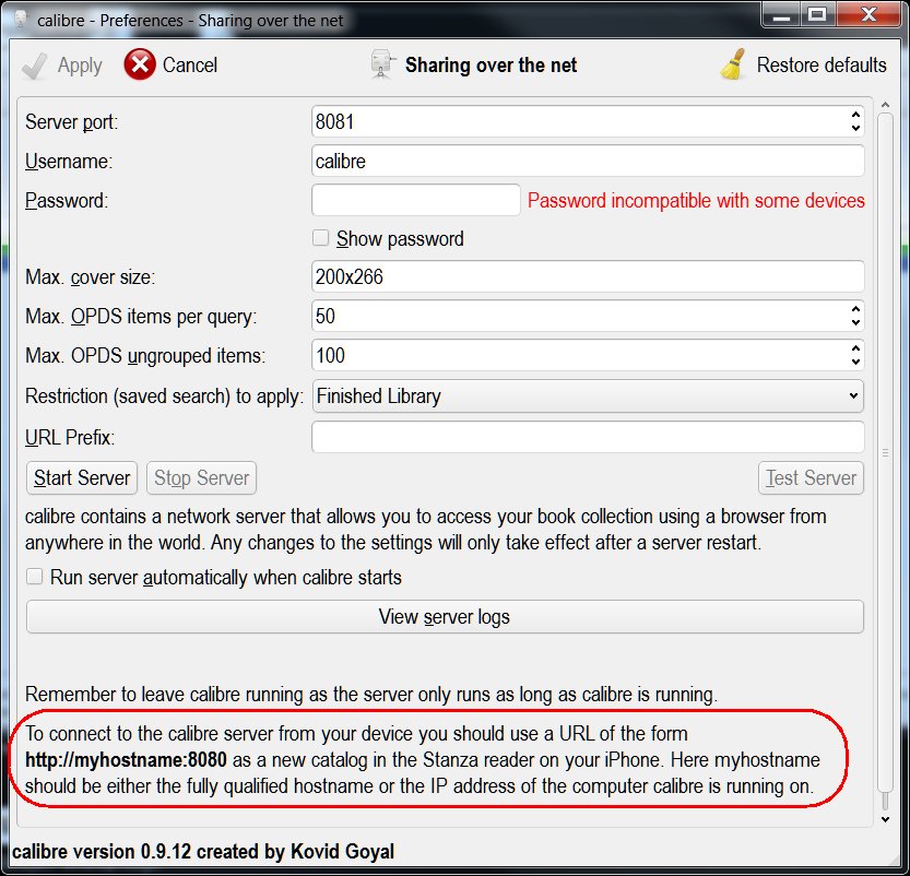

LAN management and local router configuration is not part of calibre. If you have a router port forwarding is knowledge required to get many programs access to the internet at large. I have never setup calibre for access to the internet, but have run into multiple other programs that required port forwarding for the program to properly work. It seems calibre was the first program you personally have run into that required this.
Good reading!
