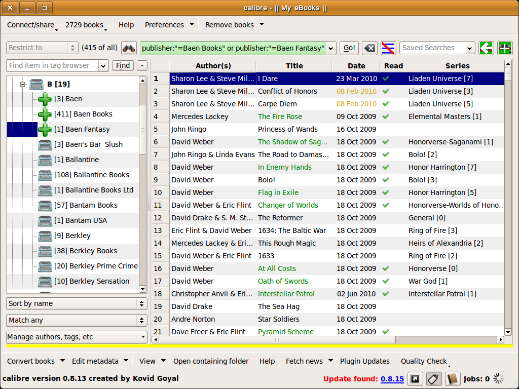

That is a lot of clean up to do
How does this magic tool decide which (similar names) can be combined and which should not?
Example from my test lib: Authors
the first 3 are all the same publisher. the next one is only similar in name.
then there is the Berkley (grouping). When to combine imprints, and leave as is ?
Or for Authors : Do you combine all those with the same surname?
