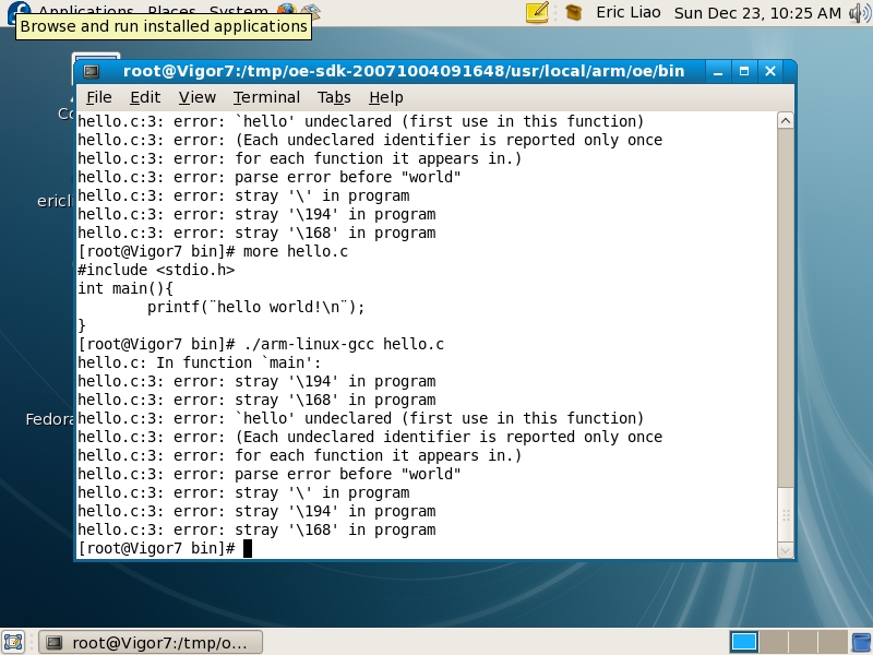

I tried to build my first app but failed. The attached file is the screent of the source code and the error message by gcc. Please help. Thanks.
I used Fedora Core 8 on a VMWare.
[Edit]
I solved the problem. It's the problem of VMWare. In VMWare, when I type quotation mark, I have to type twice to make it show on the screen. I don't know why. So I edited the "hello.c" in my Windows XP, then transferred it to Linux under VMWare. It works.
