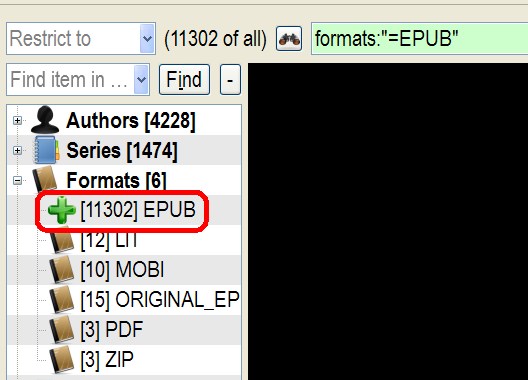

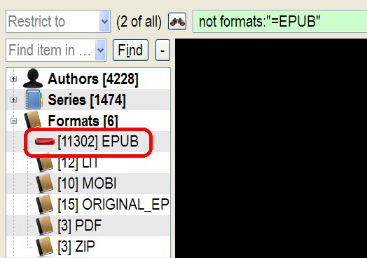

Originally Posted by slayda View Post
Thanks, theducks. Now where would I have found that information if you hadn't told me?
As theducks says using the tag browser you can look at any format. Clicking on ePub (Green plus) shows you all ePubs, clicking on it again (Red minus) shows you all that are not ePub, see attached.
theducks added formats:true to show you only the books that have actual book files inside them. Many folks add empty books to calibre to track their paper editions. This section of the manual describes the search bar and how to use it.
ID:	75052   Click image for larger version
